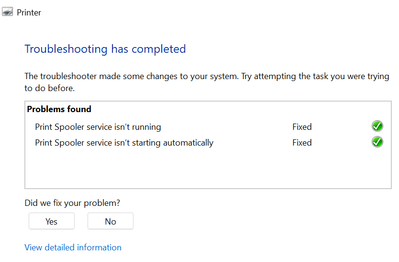

My cannon started printing poorly to the point where you cannot even read the text. I have changed all ink cartridges, cleaned the head, deep cleaned the head, did an aligner adjustment, cleaned the rollers, and ran the troubleshooter. I am at a comp...

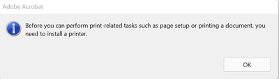

Brand new TR4720. Worked fine. Showed in Control Panel/Devices. Then I messed up a setting and removed the printer and reinstalled. Now it does not show in Control Panel/Devices. It works fine. It shows in Device Manager. It shows in System Settings/...
