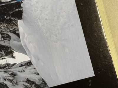

beginning of print
end of print

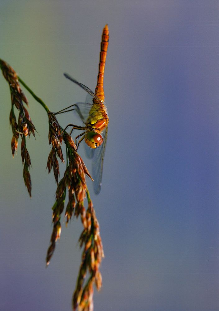

beginning of print
When I print on format A2 I get horizontal lines at the beginning and end of the print, the first and last 5 cm of the print, see photos. In between the print is perfect. The paper I use is Canson Baryta photographique II 310 g/m2 and totally flat before use. Nozzle check pattern is OK, prevent paper abrasion is on, vacuum by default is on.
Does anyone have an idea what it could be?

08-18-2023 02:56 PM
Hi,
Thanks for your reply.
I use MacOs Ventura 13.4.1 and Professional Print and Layout version 1.3.6, the latest firmware for the printer, driver version 24.30.0.0 and all the necessary plugins and ICC profiles.
I made an A4 print today and the stripes are visible here too. I used photoshop to make it clearly visible on the scan.
The nozzle check pattern is perfect. It is only at the beginning and the end of the print. I think it's the vacuum system. Is it possible to set this system stronger? Or is there an other solution I can try?
Kind regards,
Eric
stripes at beginning and end

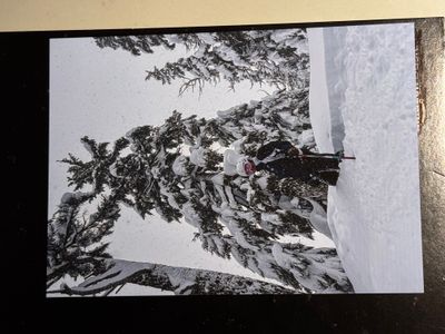

11-07-2024 11:06 PM
Hi ERMU, I just got a Pro-1100 and notice something similar when using MOAB Lasal (matte 235) 5x7 paper. Did changing the distance of printer head fully resolve this for you? I only notice the lines at the beginning of my prints.
