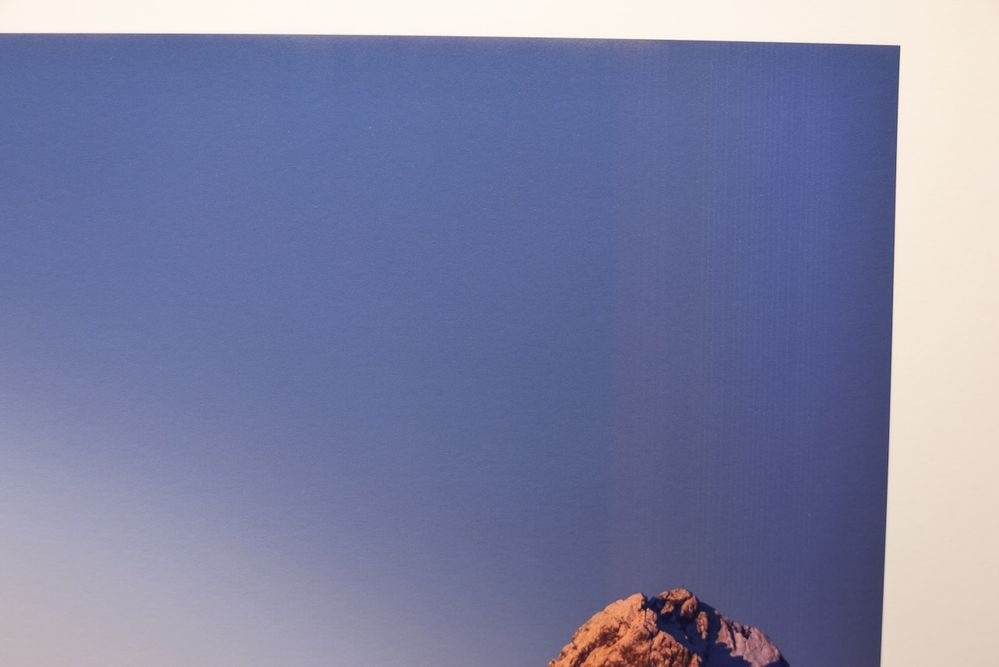

beginning of print

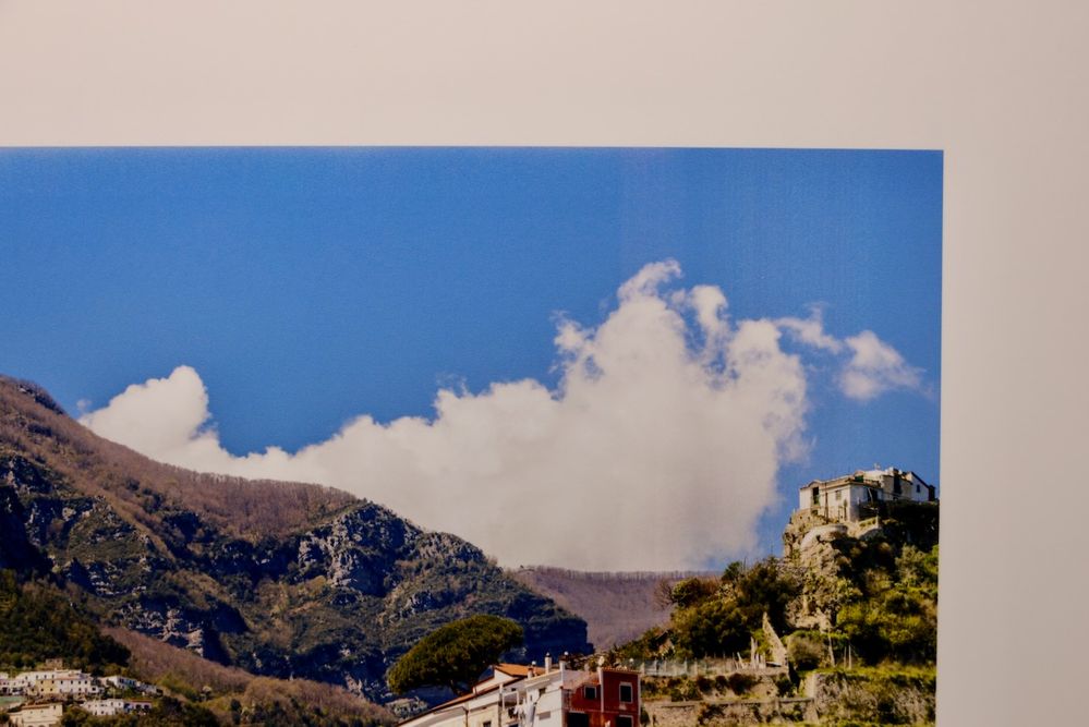

end of print
beginning of print
When I print on format A2 I get horizontal lines at the beginning and end of the print, the first and last 5 cm of the print, see photos. In between the print is perfect. The paper I use is Canson Baryta photographique II 310 g/m2 and totally flat before use. Nozzle check pattern is OK, prevent paper abrasion is on, vacuum by default is on.
Does anyone have an idea what it could be?

08-18-2023 02:56 PM
Hi,
Thanks for your reply.
I use MacOs Ventura 13.4.1 and Professional Print and Layout version 1.3.6, the latest firmware for the printer, driver version 24.30.0.0 and all the necessary plugins and ICC profiles.
I made an A4 print today and the stripes are visible here too. I used photoshop to make it clearly visible on the scan.
The nozzle check pattern is perfect. It is only at the beginning and the end of the print. I think it's the vacuum system. Is it possible to set this system stronger? Or is there an other solution I can try?
Kind regards,
Eric
stripes at beginning and end

09-07-2023 01:45 PM
Hi,
The paper vacuum setting can be adjusted. Please click HERE for more information.
09-07-2023 03:09 PM
Hes, I think I solved the problem. After the latest update this problem begun. After trying everything I finally opened the menu with printer settings on the printer itself. I never touched it before. To my surprise the distance of the printer head there was set on the minimal distance and not the standard distance. After setting it on the standard distance the problem was solved. I didn’t even know the existence of this menu. Give it a try, maybe this setting is changed with the latest update, I think version 3.02. I couldn’t find anything about this update by Canon but it was the latest firmware I installed.
Eric

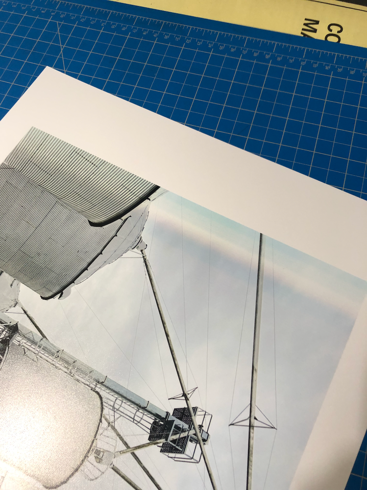

05-15-2025 11:48 PM
I too can report a similar experience. Using Pro-1000, printing on Moab lasal exhibition luster 300 gsm A3+ (very close to 13" x 19"). Band of the absence of perhaps cyan or blue running perpendicular to the direction of travel through the printer starting about 3" from the trailing end of the sheet. Read the above comments, checked on the printer Various settings > Device Settings > Paper-related settings > (choose my paper type) > “Paper Thickness (Head Height)” was set to “Low”, I changed it to Medium High” and the band no longer appeared.
Thank You! to those before me that left behind the information that led me to this. I appreciate it.
It would be nice to have a greater understanding of why this setting can create this type of visual effect.
05-19-2025 12:01 AM
And then today, I print another copy of the the same file, same settings, and I again have soft-edged horizontal band running perpendicular to the direction of travel through the printer! Tried it again, making sure I had used the setting I spoke of in the prior post, and also checked in the print driver that "avoid abrasion" was chosen, and "vacuum on" was chosen, but alas, no change in the output. (see photo). What is going on here?
05-19-2025 12:20 AM
^^ This is my post on horizontal banding lines. The one and only thing I found to make a difference is the "Pause between scans" option, which I set to 5 seconds with substantial improvements. Not a great solution since it massively slows down print speed, but perhaps worth a try.
I will also say though, the bands in your picture look a bit different than the ones in mine.
