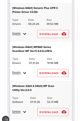

For the 665Cdw, I would only download and install these three files.
The printer driver v3.50 for printing.
ScanGear for advanced scanning control and capability
The MF Scan Utility for basic daily scanning tasks. You'll probably use this most frequently, but it's nice to have scangear for more advanced features and control when you need it.
You can install them in the order they appear. The print driver first, scan gear second, then the MF scan utility. Everything else is optional but not needed for a "bloat free" installation.
