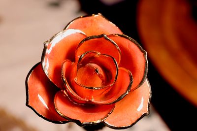

My colleagues have given you an excellent explanation about IBIS. What you see on page 242 is what is commonly referred to as "Pixel Shift" (see this Wiki article). Leave it to Canon to break from the norm with their feature naming 🙂 This technique is made possible by IBIS where the sensor is moved, pixel by pixel, then combined to make an image with higher resolution. Most camera manufacturers combine the shots into Raw, but Canon creates a JPeG file, and trust me brother, it is huge compared to a single Raw file.
I messed around with this feature soon after I bought the R5. A typical JPeG image was in the range of 24,576 x 16,384 pixels and weighed in at a hefty 161MB. Your camera and subject must be stationary. I posted some results in the Gallery on this forum. Attached is a sample, which has been reduce to 2000px from the full frame dimensions listed above.
EOS R5, RF 100mm f/2.8L, 1/40th, f/7.1, ISO 800.
