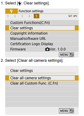

Reset the camera settings to defaults
Wrench Menu Tab 5 - Clear main and custom settings
Canon Knowledge Base - Canon : Product Manual : EOS REBEL T8i / EOS 850D : Clearing Settings
Power off the camera.
Power back on and test on / off
With nothing but the battery inserted, if the camera will not power off normally, exchange the camera at the place of purchase.
