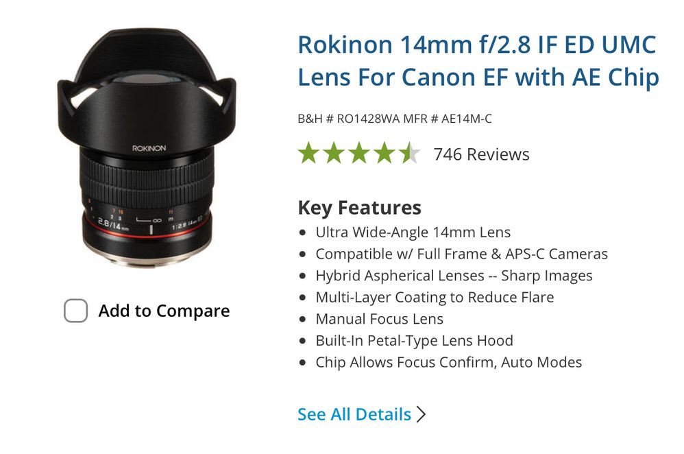

The camera should still produce a confirmation beep when the lens is set to MF, just like the lens below allows the camera to give you a confirmation beep.DDD24BDD-E024-415B-BD23-822CFC3C5617.jpegDDD24BDD-E024-415B-BD23-822CFC3C5617.jpeg
