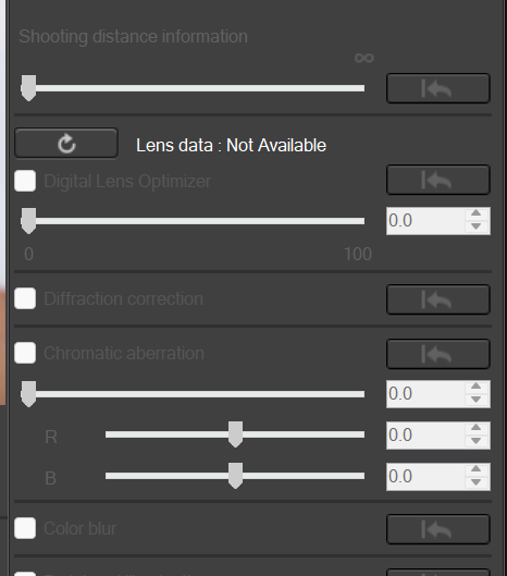

When you open the raw image in DPP, press CTRL / CMD I to show the info panel, this will show lots of information about the camera settings and also the lens. Does it list there as the EF 24-105mm f/4L IS USM?
I found an old image in my archives with the EOS 5D Mark III and EF 24-105mm f/4L IS USM. If I open in DPP then the information panel shows the full lens info. If your lens is not reporting this then it might be a lens issue.
This is what I see
11-24-2024 06:43 PM
I agree it's something with the lens.. EXIF info from DPP here:

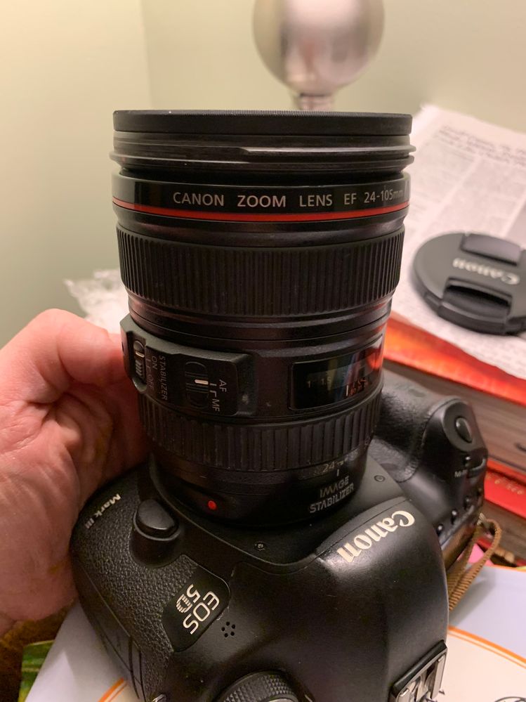

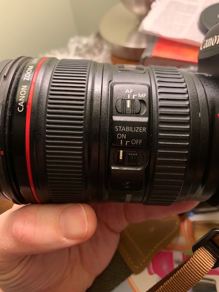

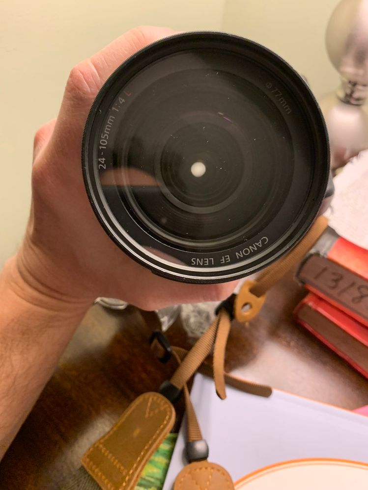

Can you post a sample picture in the forum taken with that lens. Also pictures of the lens itself too. It's odd that it just says 24-105mm but not the whole lens name. All of my Canon lenses old and new show their entire and exact names. Even my old film era EF lenses from the beginning of the EOS line. Their full and exact names are reported in the metadata such as EF 35-70mm F/3.5-4.5, EF 50mm F/1.8 or 70-210mm F/4. If the camera doesn't know the full name of the lens mounted it cannot apply the correct lens correction profiles.

I looked at the metadata and it reports "Canon 24-105mm". I had one 3rd Party Sigma lens that I used on the EOS 90D and the camera reported "17-50mm". In the lens correction menu options but the metadata reported the full name of the lens Sigma 17-50mm F/2.8 DC OS HSM. That lens didn't play nicely with the EOS 90D it has AF issues with newer bodies. But it worked fine with my old EOS 40D. How does the lens work on a different camera the supports in camera lens correction. Not all cameras support in camera lens correction such as my old EOS 40D. But I could easily use lens corrections in post even if the camera doesn't support it in camera.

It's a 5D Mk III and I believe this was the kit lens that was sold with it...
In the EXIF data, both online readers I used reported this:
