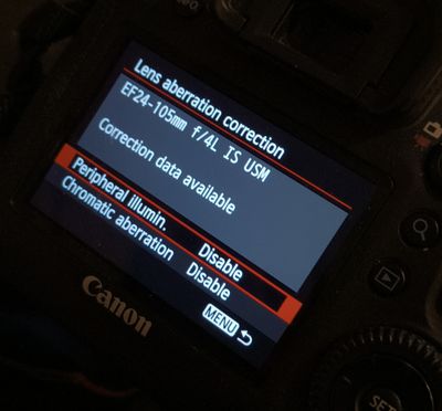

Hello,
I believe my lens is reporting "24-105mm" to my 5D mk III instead of the expected "Canon EF 24-105mm f/4L IS USM"
Thus, the in-camera Lens aberration correction is not available.
Also, DPP 4.19.30.0 reports Lens data:  Not Available.
Please note that my 50mm lens works correctly with these features and I successfully used the EOS lens registration utility, etc.  I've downloaded the lens profiles in DPP..  I've done all that.
Yes, this is on a full size RAW file.
Help?  Anyone seen this before?

Took the lens to the local camera shop today and tried a different copy of the same lens.
Other 24-105 lens works correctly.
Lens in question also shows the "24-105mm" lens info on a different camera.
At this point, I'm going to sell the thing & buy a different one.
I think that the possible ribbon/flex cable flakiness is the most plausible answer.
Thanks for the help!

Thanks.  Did the camera show "24-105mm" before uploading the data to the camera?
Is the DPP Digital Lens Optimizer dependent on having uploaded the data to the camera first?
Thanks for the reply.  I have the latest firmware on the camera, 1.3.6
The lens is the original, not the "II" version.
Is the DPP Digital Lens Optimizer dependent on having uploaded the data to the camera first?  I thought that would work even without the camera having the lens aberration correction data in it.
EOS Lens Registration tool shows that the box is checked for both versions of the 24-105 f/4L..

Share an unmodifed JPEG from your camera+lens and we can take a look what the Exif says. The LensType nr for your lens should be 237.
LensIDCanon 24-105mm
LensInfo24-105mm f/0
LensModel24-105mm
LensSerialNumber00000083fc
LensTypeUnknown (60397)
