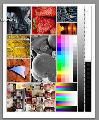

The last thing I can think of to try. Download and print this test image. Just open it in LrC; no adjustments regardless of how it looks on screen. How does the print look?
PrinterEvaluationImage_V002_ProPhoto.tif
Here is my screen capture:

I will be interested to see how the test image prints.
01-12-2025 08:52 AM
I just printed this using the ICC profile I regularly use. It's not awful, but the colours aren’t as vibrant as expected, and there seems to be a magenta tint. I’ve noticed that some images are more affected than others. I’ve been printing from a test image that I know well and can easily compare (it has a lot of cyan). This helps me determine if the print is coming out as it should.
I'm not sure what else to do but I want to thank you very much for all your help, John - I do so appreciate it.
01-12-2025 08:59 AM
I’m at a loss. Sorry I couldn’t come up with a solution. You have checked all the boxes on things to try.
