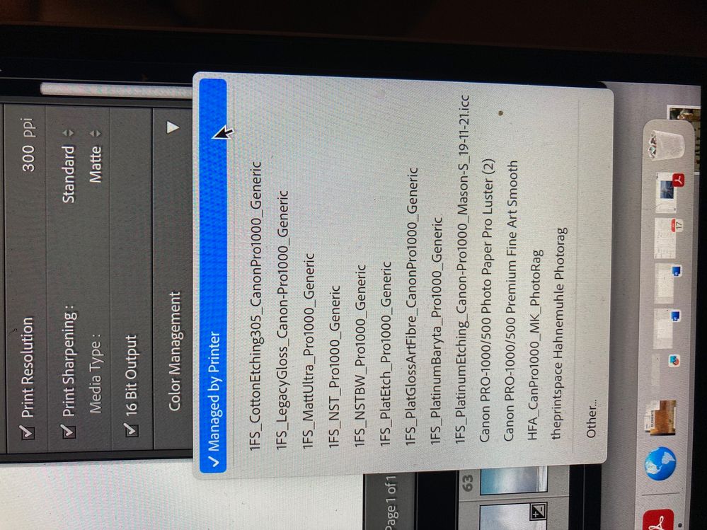

I'm getting confused. Normally, in Lightroom, I set the Colour Management to whichever ICC Profile I require. I then select the Media Type. In Print Settings, the Colour Matching defaults to 'Colour Sync'.
Earlier, when I tested whether the ICC Profiles could be corrupted, I set the Colour Management to 'Managed by Printer' thus deactivating the option to select an ICC Profile. I could still select the Media Type. In this case the Colour Matching defaults to 'Canon Colour Matching'.

01-11-2025 06:05 PM
I never have the settings in Lightroom configured to Printer Manages Colour. If I did, I wouldn't have the option to select an ICC Profile. It's an either/or selection. See screen grabs attached.

It all look correct.
If I select Managed by Printer I have no other options in LrC. In the macOS driver ColorSync is greyed out and Canon Color Matching is selected. I select the media type in the dropdown, but all I get is Canon brand papers. The driver selects the correct Canon ICC profile. I can't use third party papers if I have Printer Manage.
If I select a profile in LrC then in the driver ColorSync is selected.
Then I select the Canon media type that the paper manufacturer says to use.
