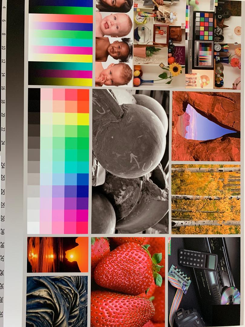

4. I have just downloaded the test image and printed it out to check. Everything looks ok to me except the pink-skinned baby gets a a bit more pink in the printed photo and the tear-drop sky between the rock looks a bit more pink/purple. I'm attatching the photo of the printed test image here. Can you take a look to see if everthing else looks ok?
jrhoffman75
Hello. Yes, the light skinned babies are more pink than should be.
What software are you printing from?
What paper?
Are you letting software or printer manage color?
John Hoffman
Conway, NH
R6 Mark III, M200, Many lenses, Pixma PRO-100, Pixma TR8620a, Lr Classic
Thanks again John,
 1. I've used LR print module for printing. I've also tried to print it using Canon Print Studio Pro plugin in LR. It didn't make a different.
2. Paper is Canon photo paper pro luster 8.5x11
3. I've tried both print managed and Canon PRO-100 <LU> ½ pro paper pro luster ICC profile. They both produced similar results.
BTW, my monitor was just calibibrated using xrite x1studio before the printings.
Monitor calibration won't affect the test image as long as you aren't making any adjustments in the software.
The grayscale ball things (I have not figured out what they are) also look yo have a pinkish color cast as well.
