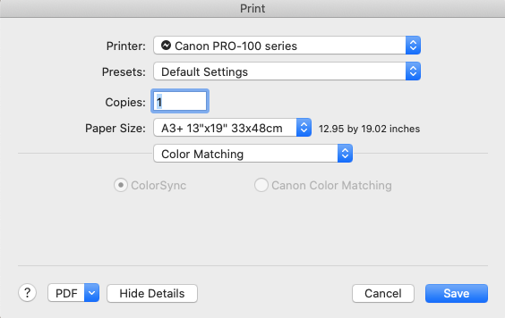

Hello I have a Pixma Pro 100. I have been printing art reproductions for almost two years with this printer with no problem. I recenty updated my Mac to Catalina, and my printer has been printing with a Pink/Magenta Cast ever since. I print on MOAB Entrada Bright Rag Paper and have downloaded the ICC profile. Can someone please explain why I cannot edit the color settings as they are "grayed out". PLEASE VIEW SCREENSHOTS.

If anyone could help guide me in the right direction to get my prints looking good again, that would be very much appreciated.

Those settings are grayed out because you want to have printer color management disabled when you are having Ps manage color.

I see you are allowing Photoshop to manage color in your workflow.  However, the printer driver is also managing color which is why you are getting pinks and magentas in your output.

I am also using the exact ICC profile for the printer and authentic Canon Ink. I am really at a loss as to why the prints are looking off.  Any help woud be greatly appreciated. If you need me to pull any other screenshots, please let me know.

Your's and my Ps dialogue look the same (except for paper profile)
Your Driver dialogue screenshot is correct.
In the Quality & Media setion of the driver did you select the Canon media type recommended by the paper vendor? Looks like you should be selecting Other Fine Art Paper 1, Quality High.
