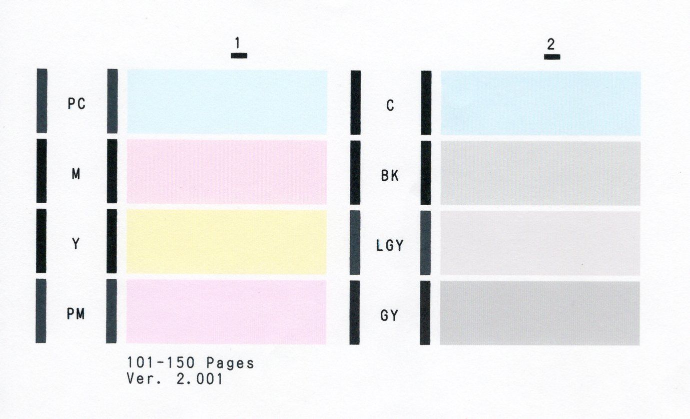

I haven't used this printer for awhile but recently I've noticed that the colors in the prints are a slightly darker than they appear on screen.  I ran the nozzle check and found that there weren't any streaks but the colors were not appearing as they should (see below).Canon Pro-100 nozzle check.jpg
As you can see the magenta is practically the same color as the photo magenta as well as the cyan and photo cyan. Also, the black is lighter than the gray.   I replaced the cartridges and the result was still the same.
I've cleaned and deep cleaned the heads but it still doesn't make any difference.
Can anyone explain what I would need to do to get this to print properly again?  It used to work beautifully.

Here is what Canon says the nozzle check should look like:
Yours looks OK.

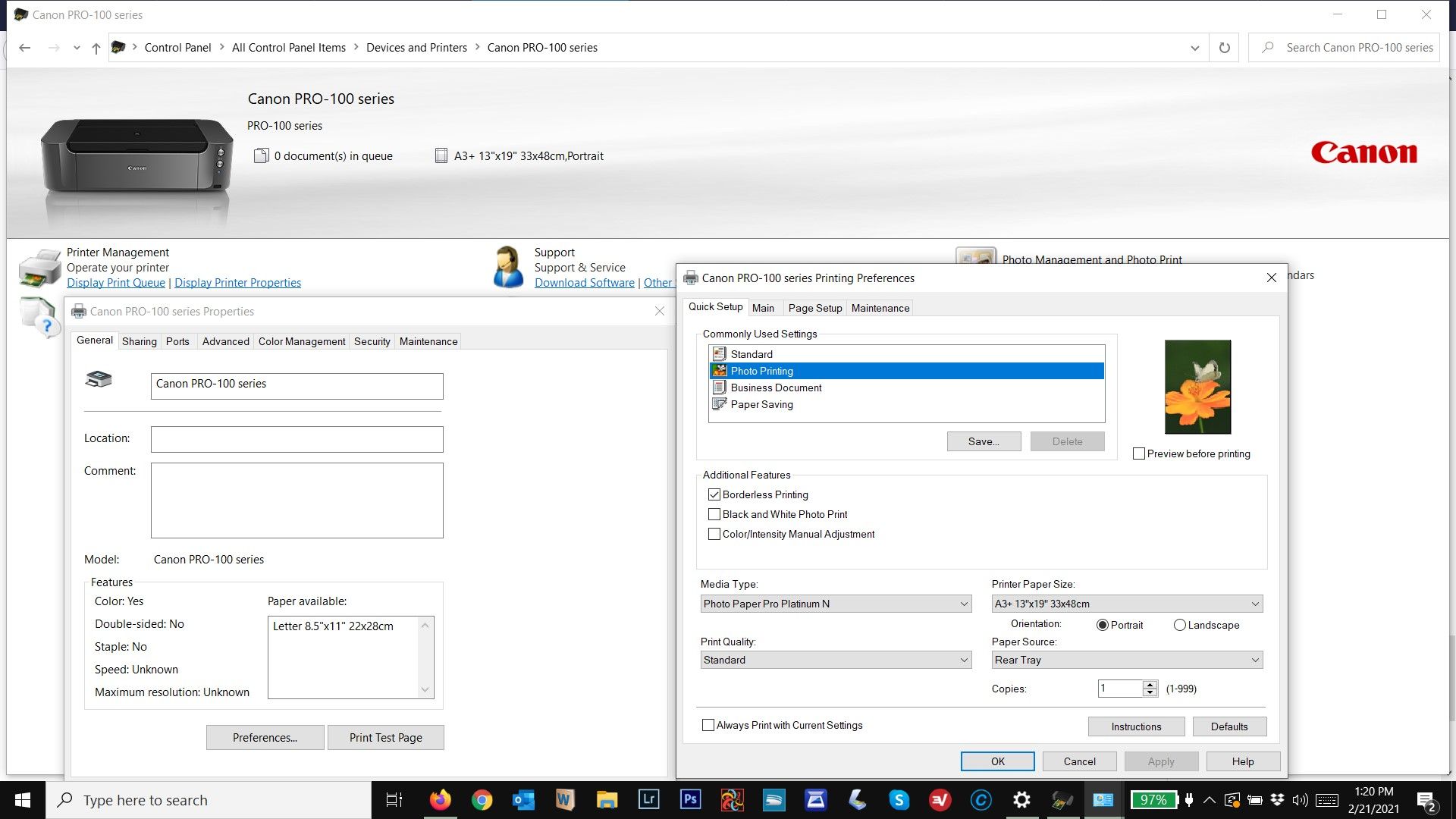

Can you print a screenshot of the settings you are using?
By any chance, if you go to Devices & printers in the Control panel does your printer have WS after it?

The printer name does not have a WPS suffix.
Here are the settings as requested. Let me know if you were looking for something else.
