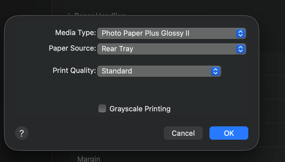

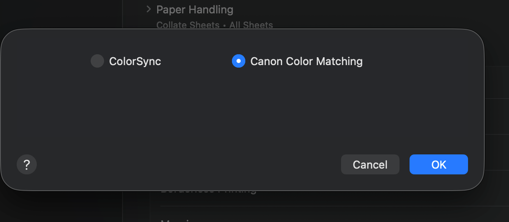

My iP8720 is printing with a heavy pink/magenta cast on any photo paper setting. Blacks come out purple, dark areas are washed out. Plain paper prints perfectly with correct colors.
This is the first time I've printed since upgrading to macOS Tahoe (26). It worked fine before the upgrade.
Troubleshooting completed:
  • Replaced PGBK cartridge (new, genuine Canon)
  • Replaced BK cartridge (genuine Canon)
  • Nozzle check pattern prints perfectly — all channels clean and solid
  • Downloaded and installed fresh driver from Canon website (Sept 2025 version)
  • Reset macOS printing system completely
  • Removed and re-added printer via USB
  • Tested multiple media types in driver: Glossy Photo Paper, Photo Paper Plus Glossy II, Matte Photo Paper
  • Tested from multiple applications (Photos, Preview) — same result
  • Canon Color Matching selected in print dialog
Results:
  • Plain paper + plain paper setting = correct colors
  • Any photo paper setting = severe pink/magenta cast regardless of actual paper used
Is this a known issue with macOS Tahoe? Is there a driver update planned? Any workarounds?

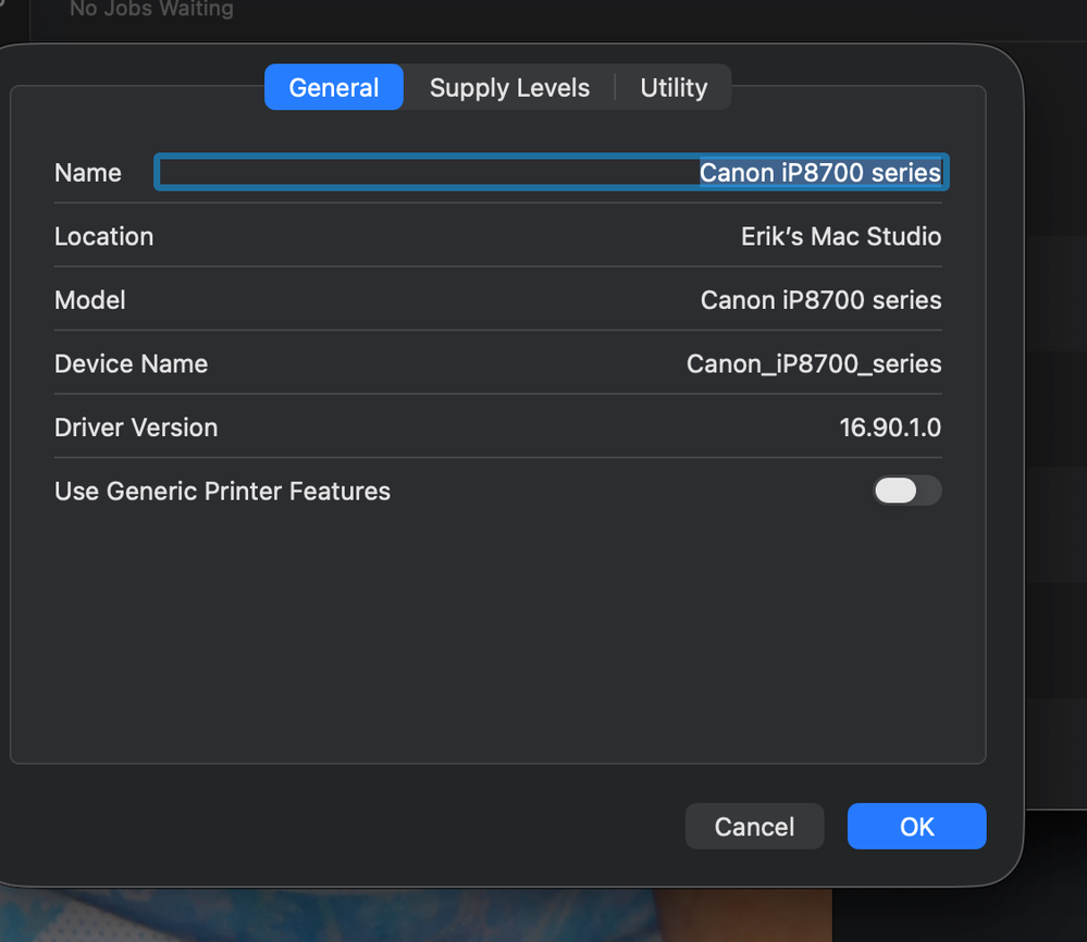

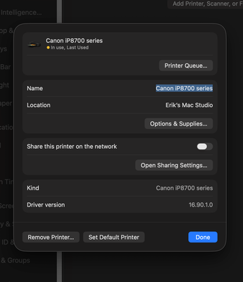

I appreciate the response, but I still have a couple of issues. First, I have reset the Print System and reinstalled the drivers per my post. I don't see a Color Profiles option when following your path from Settings to Printers & Scanners, nor is there any mention of Print as Color Target. I have also reviewed all the settings available in the printers utility and have found nothing. I haven't downloaded the Colorsync Utility, but since I've never had a reason to use it, I am wondering why I should now.

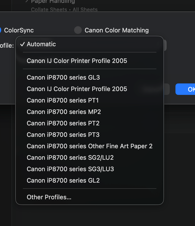

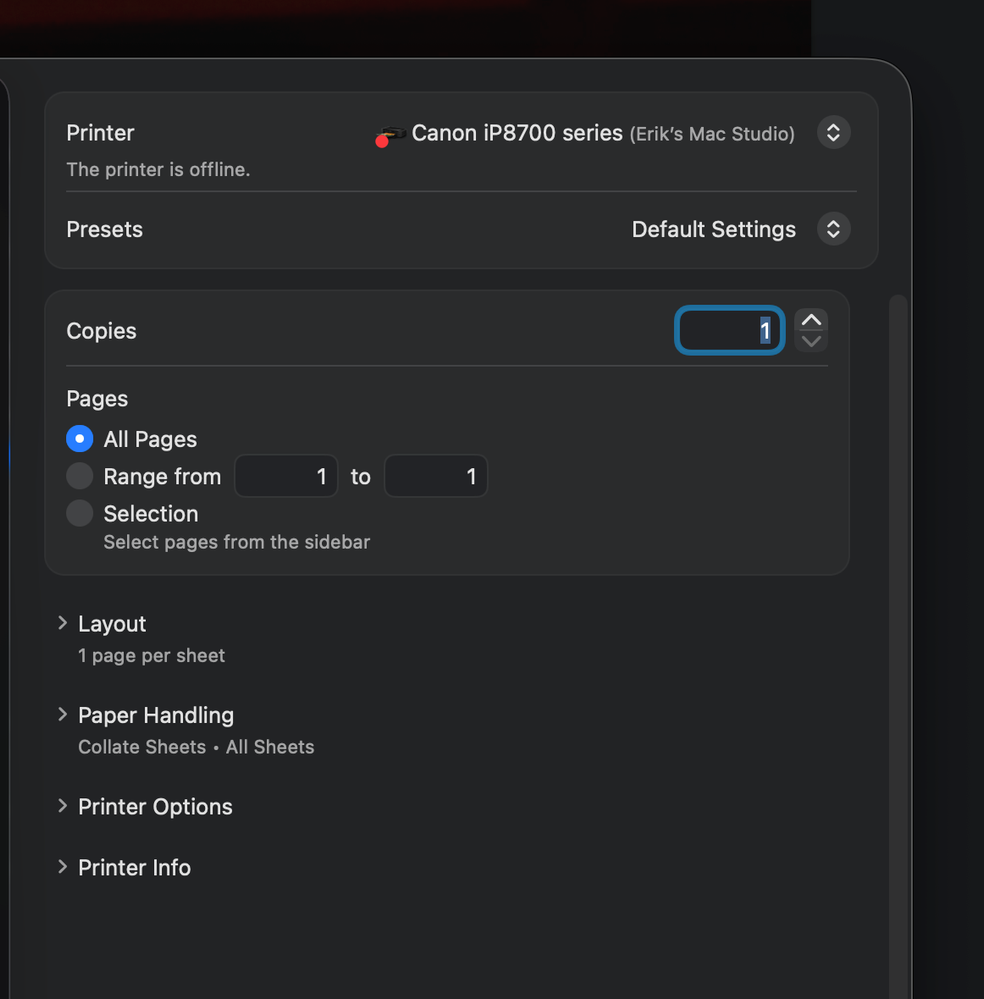

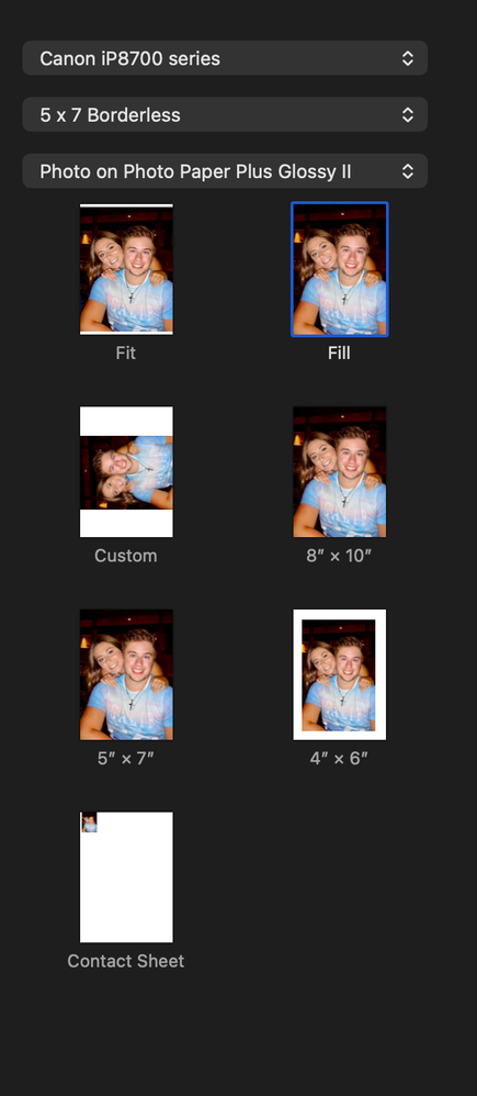

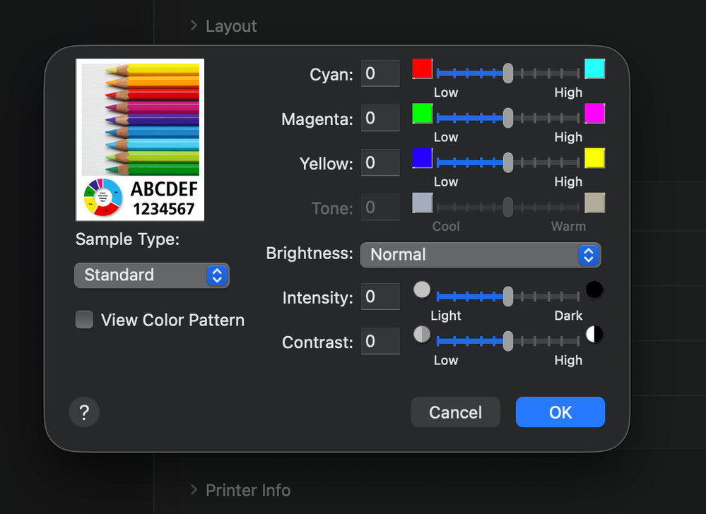

Magenta cast sometimes indicates double profiling. Can you post a screenshot of the print dialogue settings indoor photo app?
John Hoffman
Conway, NH
Thanks for the reply. I included everything I could think of. Let me know if you see an issue that I am not.Screenshot 2026-01-30 at 10.52.00 AM.png
Screenshot 2026-01-30 at 10.49.35 AM.pngScreenshot 2026-01-30 at 10.50.07 AM.pngScreenshot 2026-01-30 at 10.50.18 AM.pngScreenshot 2026-01-30 at 10.50.30 AM.pngScreenshot 2026-01-30 at 10.50.41 AM.png
I don’t see anything that would indicate a problem. What happens if you select ColorSync?
John Hoffman
Conway, NH

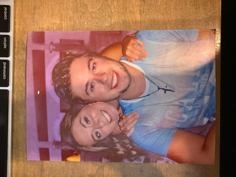

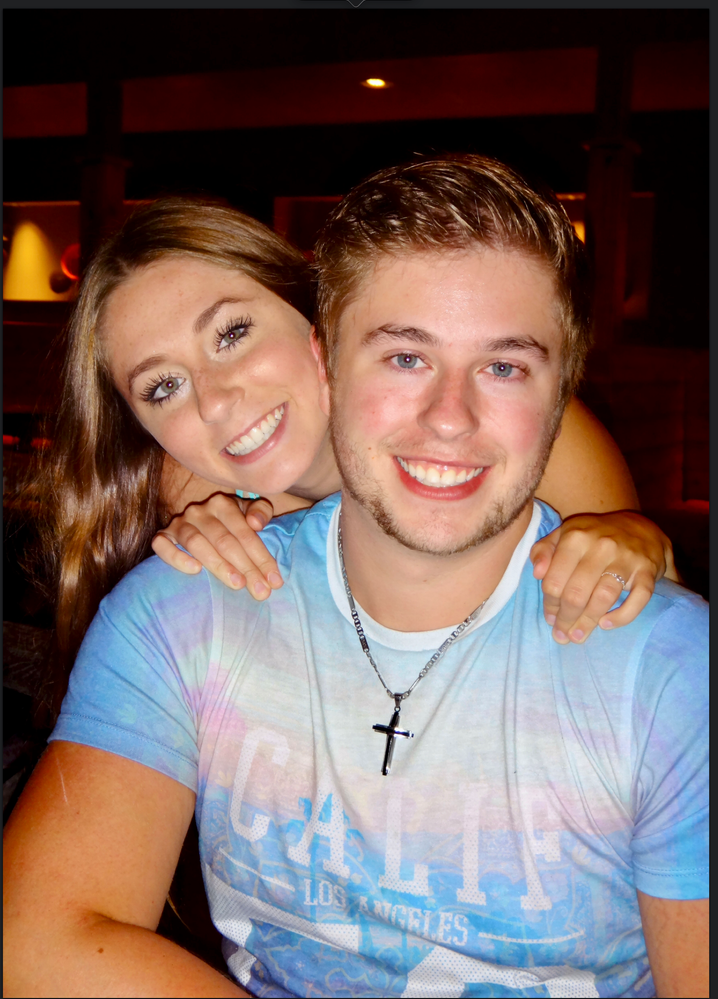

I opted for automatic in Colorsync and it yielded the same result. I included a screenshot of what I expect (the darker image) and the print for comparison.
Thanks!

I really hate to ask but do you have the glossy paper loaded in the rear tray, glossy side up?
Seeing this I suggest you run a nozzle check.
John Hoffman
Conway, NH
Lol valid question and yes its load correctly, logos on the back. I would have asked the same.
