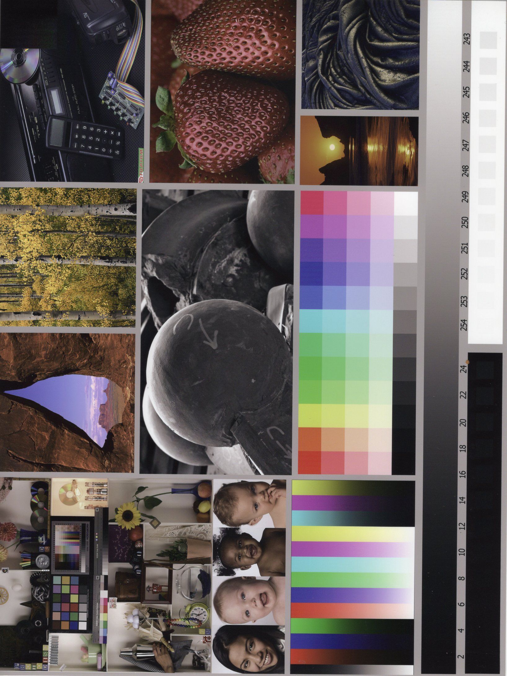

Prints slightly darker than screen doesn't necessarily mean a printer problem. It could be your screen is too bright.
Print this test image and see how it looks. Are the colors OK? Does it look like a nice print?
http://www.outbackphoto.com/printinginsights/pi048/essay.html
02-20-2021 08:45 PM
Hi John,
Following is the printer evaluation image as suggested. Sorry I couldn't get it rotated but hopefully you'll still be able to review it.
As you can tell everything is a shade darker than it should be. It's close as I said but not quite accurate.
Any thoughts on this?
Don

02-21-2021 05:28 PM
In looking back at your nozzle check screenshot it looks like you have vertical bars in the color swatches.
Maybe try performing a nozzle alignment in the driver maintenance section.
Even though the image looks dark it appears like it has a black filter effect over it rather than just a brightness issue.
What software are you printing from?
In the color section of the printer driver you could try boosting the brightness as a test to see how it affects the printout b
