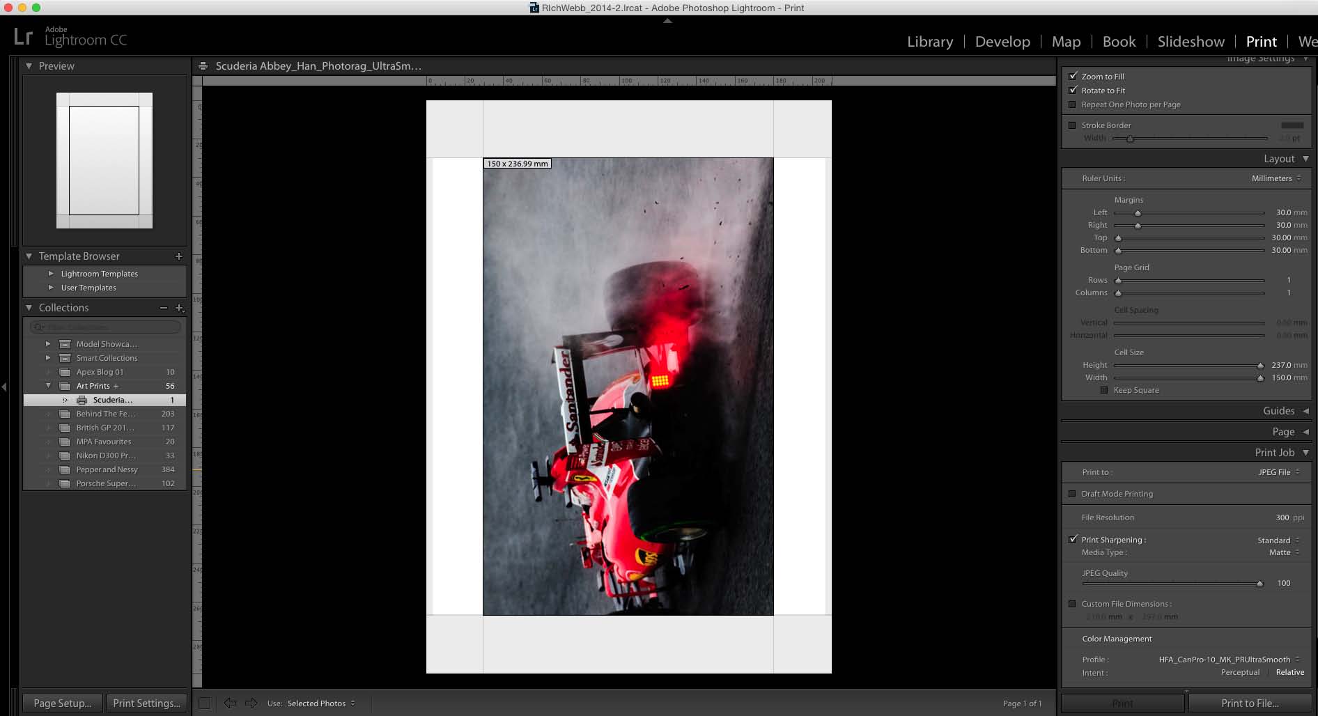

However, when I try and print to fine art papers the image will not centre - specifically on A4 (210x297mm)
I am aware of the margin 30 setting for thicker papers - but no matter how I set the job up - the print will come out off centre and at the wrong size (scanned example below)
For instance; lightroom preview gives me a printed area size of 150x237mm on a sheet of A4 which make sense - 30mm margins all around.
But when printed, prints come out smaller at a printed ara size of 210x140mm and with inconsistent margins.
The same happens in Canon's Print Shop Pro, but the alignment is inconsistent with Lightroom. Lightroom's PSP plugin also.
I have attached some screen grabs and scan so you can see the comparison of software against result.

Could you repost the section image more clearly so we can read the settings?  Thanks.

Try setting top and bottom margin to "0" since the grayed area represents the Canon imposed margin.

Thanks John, but that doesn't work.
Trying to set the margins to zero only brings up a warning about the minimum imposed margin of 30mm.
You can see the written dimensions of the printed example and how they don't match any of the settings at all. It doesn't appear to be a percentage or a scale of the preview.
In addtion to this - if I print from lightroom direct - the top edge is narrow - if i print from the print studio pro lightroom plugin - the bottom edge is narrow, but the sizes are again different.
It's very odd.

Hey John,
Yes, i;ve just double checked again and I get a good result too if i print to file - it looks great - but if i actully print a hard copy, it goes nuts. Misligned and random size.
Here's my print to file preview:
