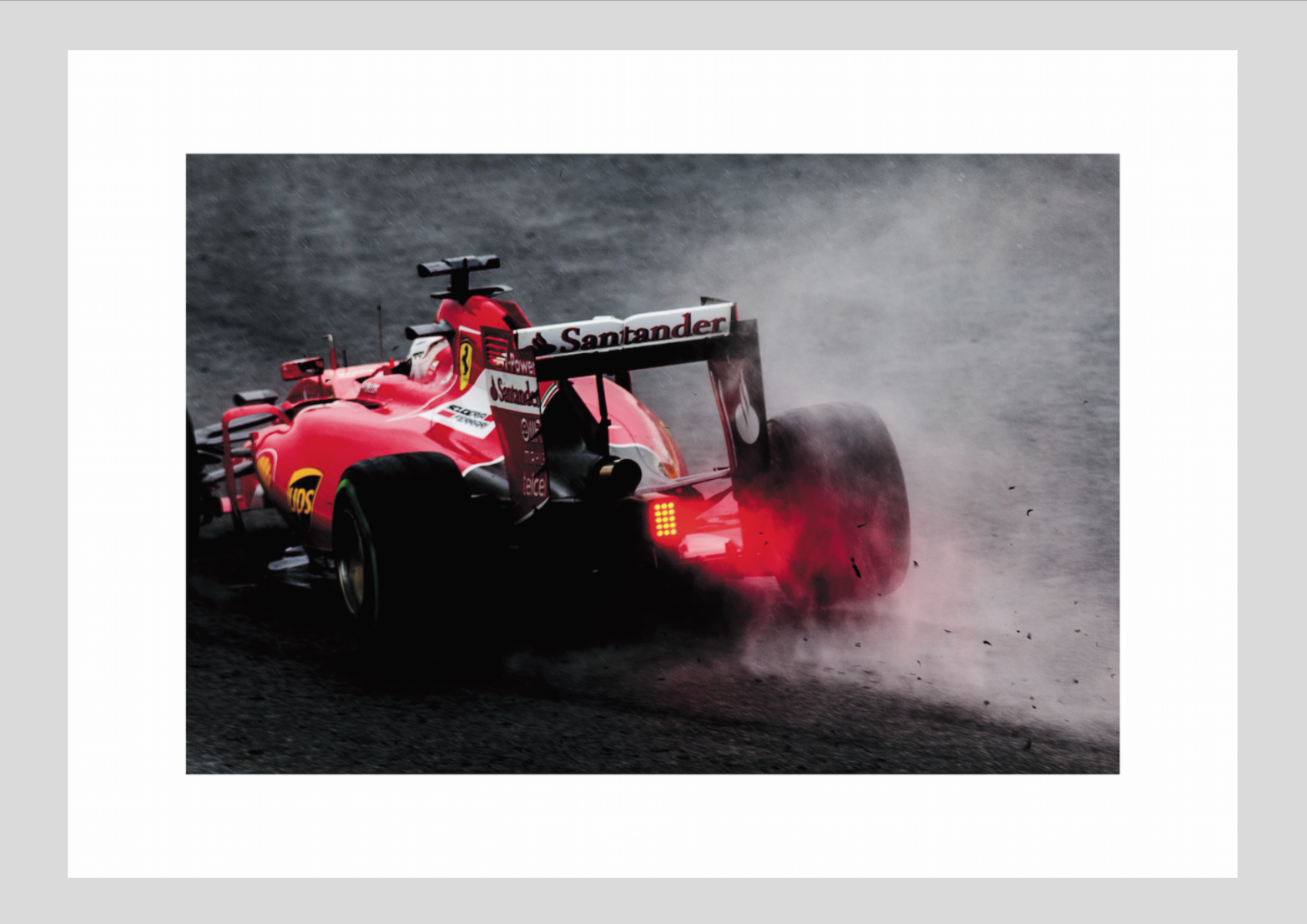

Hey John,
Yes, i;ve just double checked again and I get a good result too if i print to file - it looks great - but if i actully print a hard copy, it goes nuts. Misligned and random size.
Here's my print to file preview:
