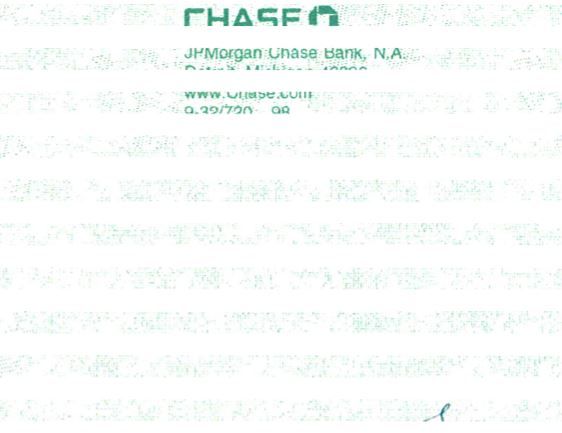

I have a mf628cw laser aio. The unit is about 5 yrs old. Lately when scanning in color I'll get this horizontal white line issue as well. Specifically it seems like every other line is white/empty. Black and white scans are defect free and correct.

Hello Das1996,
The issue looks like there is something wrong with the hardware or it is trying to copy or scan a protected item. Some items like checks, money, and certificates will not be reproduced by the scanner. We would be happy to assist with the issue. To provide some feedback or some troubleshooting steps, we would need some additional information. If you could reply to this message with the information below, we can provide some assistance.
04-01-2022 01:04 AM
You may be on to something with respect to protected documents. I've seen it only with checks so far, and in color.
When scanning the same check in bw, it scans fine. Other documents scan fine in color or bw.
Doesn't matter if the doc feeder on top or scanner glass is used.
If it is protected documents, how do I scan the check/document in color to preserve as much of the original as possible for my records?
