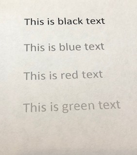

- I purchased a mf269dw to replace an old inkjet
- I want the printer to print only in black and white for text; not in grayscale
- However selecting black and white from the print menu does not help (while it did for my old inkjet printer)
- I'm experiencing this with web-content, ms-word docs, pdf docs
- My setup is a mac running 10.15.7
- I've tried looking on line for help to no avail.
- I've deleted the print drivers and reinstalled from: https://www.usa.canon.com/internet/portal/us/home/support/details/printers/black-and-white-laser/can...
- I connected to the printer using "Remote UI" and reviewed all of the settings; to no avail
- I'm at a loss
- Any ideas ??

06-10-2021 09:33 PM
Hi there; so after four long calls with Canon Support, this has happened:
1) first gent I spoke with took the time to walk me thru several things; I printed out a printer report and other pages, scanned them and sent them to him for analysis. He determined I needed a new fuser/drum... said it'd be sent overnight... well what I got 4 days later was a replacement rebuilt printer (same model) WITHOUT toner or drum! I put the only drum and toner cart I had in the new machine... same result.
2) Called back to ask why different part was sent; another rep reviewed my file and said 'that's what rep's boss told him to do." Oh. He walked me through a bunch of stuff, such as "don't plug the printer into a surge protector; plug it into wall and be sure it's the only device plugged in there." OK, did it. No better.
He talked me thru install of Canon drivers (I was using the Mac drivers that came up when I hit add a printer).
**It worked a teeny bit better, though scanner driver which I had installed under his direction is a total fail!!
He walked me thru changing the printer settings to increase amount of toner used and fine tune quality-- so bottom line is, it was barely adequate even with toner quality turned up all the way, No change.
3) Called again this week (6/7/21); got first guy again; again very nice. Said to me again it needs a new drum-- came back a few minutes later and said, it needs a toner, I am told, not drum.
4) received new Canon 051 toner cart; install it. It printed GREAT as long as printer settings were at highest setting; if I set it at standard or if I turned on Toner Saver, the printout was very light again!
What have I learned? That with toner carts costing $81 for regular, $120 for high capacity, I will likely need FAR more toner and get far fewer copies out of a toner cart than the 1500 estimate on standard setting! If I got adequate printing on Std setting, for 1500 pages, it'd cost 5 cents each printed page. BUT with toner setting needing to be high, I bet I'll get half of that (at 10 cents or more a page).
I rated the unit on Wirecutter and Consumer Reports site as poor. I will call again and request a refund (it's 9 mos old). I'm not optimistic. Good luck with yours.
