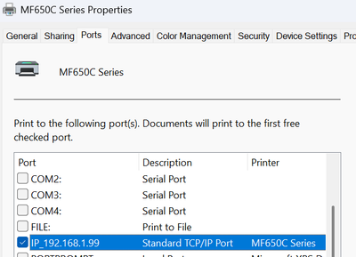

Is the printer installed as an IP printer? example
