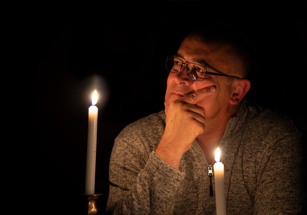

To give you an example of this, I took the following image with my camera set to BBF and AE-L.
In this example, I needed to precisely get the closest eye in focus.  So, using my BBF I aligned my single point AF to the eye and tapped the AF-On button and the focus locked.  For the correct exposure, if I had used matrix metering the camera would have considered the vast amount of black in the image and over-exposed the subject.  So, using single point exposure, I metered on the jersey by the subject raised hand and pressed the * to lock that.  I then recomposed the image and pressed the shutter to execute the shot.  All this took barely 2 secs.
cheers, TREVOR
