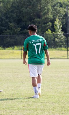

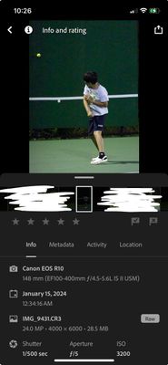

Thank you so much and yes, I started photography and last September and I used the canon T7 with the 75 to 300 MM lens, but I upgraded to the camera I posted about but the only problem I have is when I take pictures at night it’s a bunch of green and the pictures come out super dark and even when I go to edit them in Lightroom if I put up the exposure, it’s just completely bad it’s green And a lot of grain and I don’t know what to do. I lower my iso and go back to Lightroom and increase the exposure and that doesn’t help the picture comes out horrible and I don’t know if using my old lens the 75 to 300 with my Canon or 10 if that lens would help out at night both of the pictures that I inserted down below the first one is during the day the camera works great and the 100 to 400 lines works perfectly, but if you check the last photo, that’s my camera and the same lens during the night and the pictures come out horrible I haven’t tried it in a high school field because I mostly shoot soccer and I wanted to start football

So based on your images, I see now you are using a EF 100-400 adapted to your R10. Not the RF version. It would be slightly better from a aperture standpoint, but again aperture increases as you zoom diminishing light gathering capability and present challenges in low light. Your 75-300 is also not going to work in low light, not to mention it's image quality being entry level. It takes photos, that's about it.
For night time photography you are going to need a lens with at minimum f2.8 aperture. A lens with a constant aperture is preferred. This is the only way you will be able to use a shutter speed fast enough to capture the action without pushing the camera's sensor to its limits.
I'd recommend the RF 70-200 f2.8.
This is not an inexpensive lens, but you get what you'll pay for. It would be an investment that you would be able to use with this body and the next. Lenses are the real investment in photography. Body's come and go.
