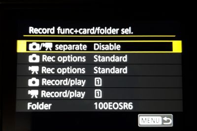

For "troubleshooting" purposes, use this card configuration. I know it works 🙂
This is the way I've set up my wife's R6 mark II and both video and stills are captured and played back. If you still have problems, we can rule out the card assignment.
*EDIT* I forgot to add... Just be sure your card is in Slot 1 if you are only using one card, LOL!

I set mines up the same and still nothing unfortunately.
