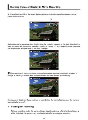

“ The camera shuts down unexpectedly during use while taking still photos (no video), under ambient temperature conditions below 28°C (82°F).“
I am sorry to hear that you are having issues with your camera. I agree with Steve. This is a social media platform. It’s neither Canon Support, Service, or Sales. Follow his advice to contact Canon Support.
As far as the camera unexpectedly and suddenly shutting down goes, the camera has a 10-segment bar graph heat level indicator. You should have received adequate warning ⚠️ about heat prior to shutdown:
I don’t know if it’s possible to disable the display, but I suggest that you check it, or reset the camera.
