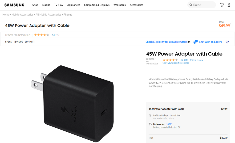

Greetings,
Samsung doesn't have full specs listed for this device. 45w, 5A. But Volts = Watts / Amps.
In general, a USB-C PD device should be at minimum 45w, 9v, 3A. Note, the battery will not charge when the camera is powered on. It could work if the pin out matches. 😉
[Commercial link removed and replaced with screenshot to act as visual aid.]
