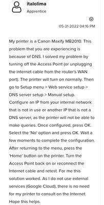

05-31-2022 09:16 PM
Here is the fix! I verified it!
06-01-2022 12:27 PM
This might be helpful to someone who is very tech savy, but not your average or below user. Furthermore, the instructions would have to be handwritten ad we can't print them. Canon Must correct this or lose many customers.
06-02-2022 05:10 PM
Hi Eileen - Agree that Canon has to fix this but I was able to follow the above info. Brought the instructions up on my IPad. I'm 85 years old and not computer savvy. This does work.
