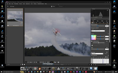

What focusing mode were you using? What display option did you select? Focus points will only show if camera is actively focusing when the image is captured. If shooting AI Servo camera can fire even if focus isn't achieved.
 Here I was activating back button focus.
 Here BBF was off to avoid camera losing focus and then hunting.

I have just checked with one of my own EOS 5D Mark IV images also captured with the EF 70-200mm f2/8L IS II USM lens. I'm using DPP version 4.20.20.0 on the Mac.
When I choose the option to display the AF points, I selected only the active AF points and there is a single one shown. To help you find it I've added a blue circle on the screen shot. I've also attached the info for the same image.
One common reason for the AF points not being displayed is that the camera was configured for back button AF and at the time the image was captured the AF-ON button was not actually pressed. In this case no active AF point is recorded since the camera was not autofocusing at the exact time the image was captured.
