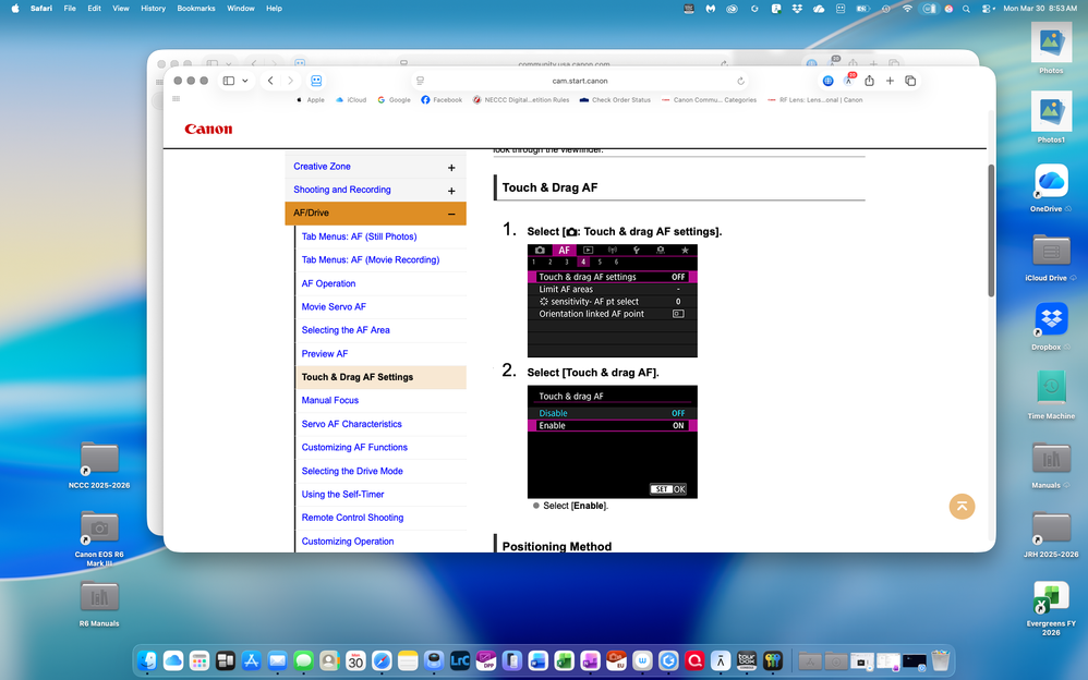

https://cam.start.canon/en/C005/
I think you want to disable this:

If you only want to disable the touch AF, go to AF screen 4, set Touch and Drag AF settings to OFF, but this only turns that off. If your nose it hitting the screen it could also hit something else maybe, so Waddizzle's suggestion of disabling Touch Control may be a better option.
