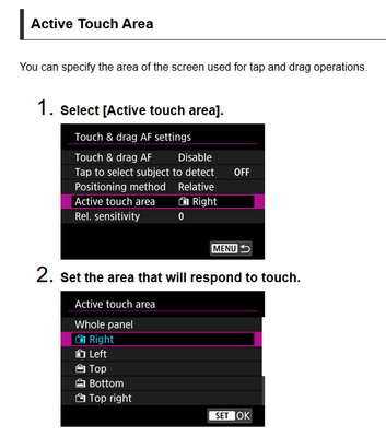

Regarding your #2, Live View is not required to use the screen to choose the focal point focus - it is called "Touch and Drag AF" and typically you'll just use the right half of the touch screen whilst your eye is pressed to the electronic viewfinder, much like the joystick.  Many people, including me, prefer it to the joystick, though one does need to train ones' thumb and cheek accordingly.
The AE lock button is easily reprogrammed to then recenter your focus area.  This is how I use that button.  A snip from the manual to help you visualize:
Since I do not use back-button AF I use that button to switch between servo and one-shot.  I found that useful for me.

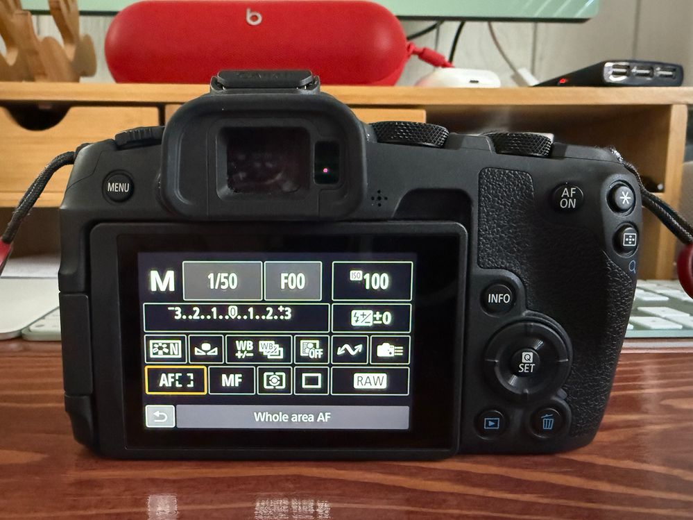

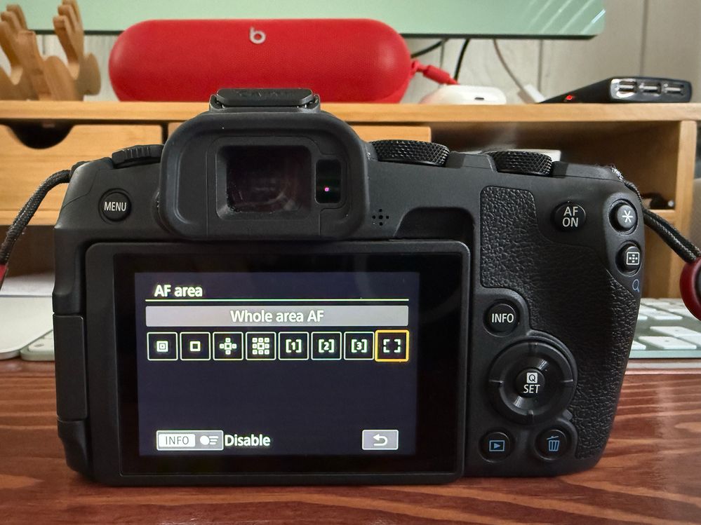

That's what I thought that you meant.  It seems like there should be a way to do this without pulling the viewfinder away from your eye, but I honestly do not know.  I don't delve into the menu like SignifDigits suggests (although I know that is the common way).  When I pull my camera from my eye I simply hit the "Info" button, then the "Set" button, and I can quickly switch from Whole Area, to whatever I need.  Yes, it still means taking the camera away from your eye, but it's a LOT faster than diving into the menu.  Even on sunny days, the high contrast black and white screen is easy to see for these few simple visual steps.  See sample images below.
If you do find another way, I'd like to know.  I agree that it was simpler on many of the DSLRs I have owned.
