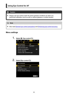

Do you have Eye Control enabled?

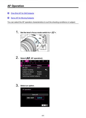

The.AF system / display can look and behave like a DSLR when disable Subject Tracking. And, disable the twi detection settings, Subject and Eye Detection.
When I work horse events, I have animal tracking on. Otherwise, subject tracking if off.

“ Eye tracking is set to off. “
What about Eye Control?  Not the same as Eye Tracking.  If yiu have Subject Tracking disabled, then so both subject detection and eye detection.
I recommend that you watch this long and exhaustive explanation of the AF system. YouTube video.
I apologize for being unclear.  Both eye tracking and eye control are set to "off."
“  Regardless of the subject be it a moving horse or a rose bud in a vase, the focal point jumps around and I miss critical shots.  “
The only reason for the AF point to move off of a subject on its own is if the AF system has one or more automatic detection and tracking settings enabled.

  • Once the camera has been reset, don’t begin re-entering your custom settings. That would defeat the purpose of resetting the camera.  We want to test the camera with settings in a known state.
However, I recommend disabling all the automatic AF settings on the menu screens I posted above. Also, double check that Eye Control is disabled.
