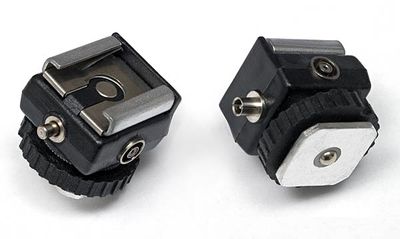

The T3 does not need a flash in the hotshoe order to trigger a flash. You just need an adapter than can convert the hotshoe to a PC connection. The Wein “Safe Sync” circuitry might not be working properly with your T3. I would try a basic adapter like this one.
