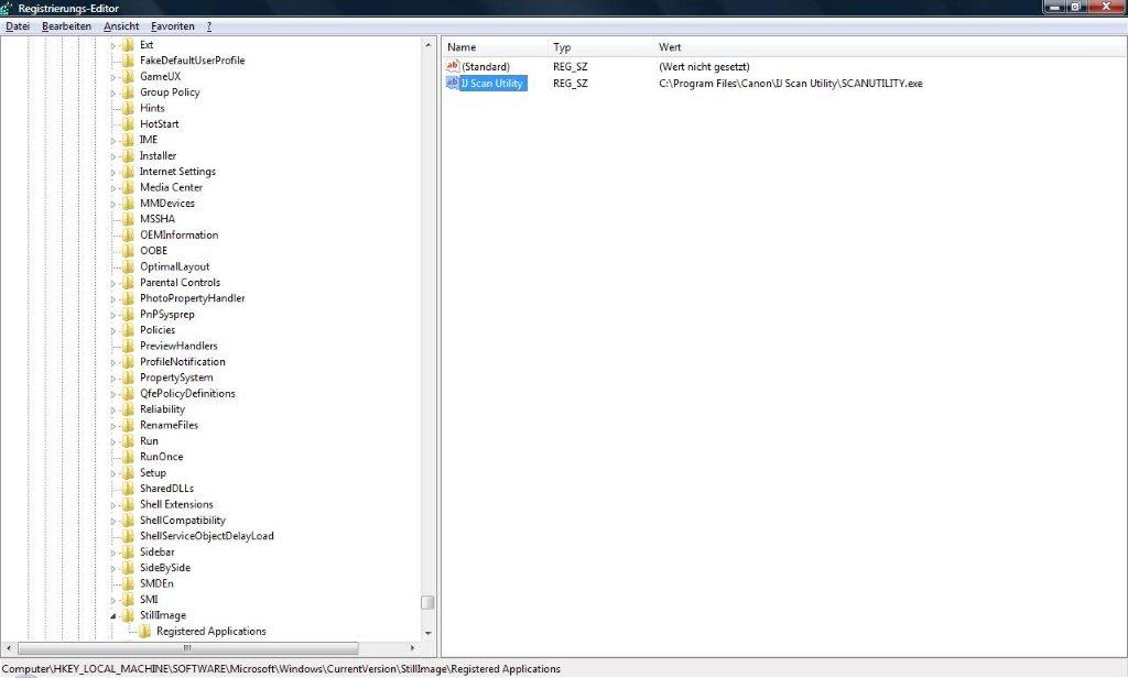

But after a little bit of searching, I found out a solution that should always work - worked for me on my Canon Lide 120.
I thought I post this here, so that other people profit from it also - although I must say, I would expect Canon to come up with a decent piece of software that works reliably.
DISCLAIMER: What I am going to explain involves direct changes of your Windows registry. That's a bit like an open-heart-surgery. If you are not careful, you can break your system. Don't blame me, if that happens. 🙂
Background Info:
Canon ships a software called IJ Scan Utility. If you install the scanner drivers, this is installed, too.
This tool is supposed to fire up, when you press one of the scanner buttons. Once it fired up, it is going to execute one of the "rules" defined in Canon's quick menu settings, where you configure what should happen, when the buttons are pressed.
If all things were as they should be, there would be entries in your Windows registry that register IJ Scan Utility as a so-called Autoplay Handler for your scanner's buttons using the Microsoft STI Still Image Application API.
Since these registry keys are either missing or not properly set, I will describe how to do that manually.
A big thank you to Matteo Rossi, whose post led me to the right direction.
So, let's get started.
Solution:
That's it. You should be good to go now. And when you press a button on the scanner, whatever you configured in Canon's Quick Menu should be executed. E.g. if you press the copy button, the scanner should scan a document and then automatically send it to your selected printer.

FYI, for anyone else out there Googling, with 64-bit Windows you will not find IJ Scan Utility in the HKLK\Software\Canon key. The path will be HKLM\Software\Wow6432Node\Canon\IJ Scan Utility.
