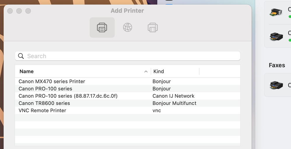

It appears, but then at no point is there an option to choose anything. Once installed, it says "air print" was installed. I do remember before I could choose in the process, but now there's no option,.
 After this, click add, and it's added as air print. No choice.
The IJ Series isn’t on the list. Bonjour is AirPrint.
I can’t explain why it’s not appearing if you downloaded and installed the Canon CUPS driver. Canon should be able to assist.

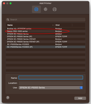

My printer is WiFi connected, you can see that it says "Canon"
John Hoffman
Conway, NH
thanks so much. I get it now. I see. For some reason I'm not getting the IP option on the Canon at all with Ventura. But you pointed me in the right direction. That may be the root of other issues with PSP as well. I'll work on it.
Screenshot 2023-05-20 at 2.15.38 PM.pngScreenshot 2023-05-20 at 2.09.47 PM.png
 Could well be related to the PSP issues. PSP works with the Canon driver.
You can see that there is a Bonjour and native version driver for your Epson printers.
John Hoffman
Conway, NH
I forced an IP installation. I have the router set for a fixed IP on all the printers. It installed. It no longer says "bonjour", but after reinstalling PSP nothing has changed. I can print directly from PS and it works through my RIP.
Sometimes we like PSP though. It's a nice to have but we'll deal without it. Thanks for all your help. I have other little things to iron out now as I make upgrades.
shadowsports
The following should work.  After the CUPS driver is installed, open printers and scanners.  Remove the Pro-1000 (minus) -, then add (+), select the Globe and re-add as an IP printer.  Enter the IP address and use the drop down to select the previously installed CUPS driver.
