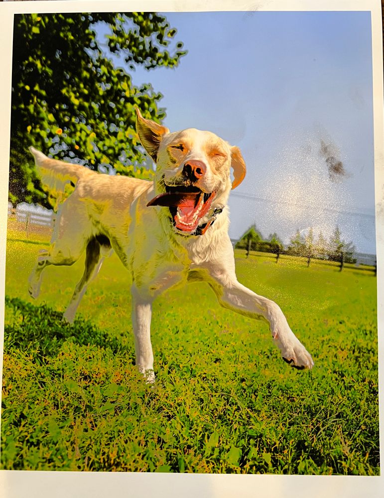

I can't seem to get my photos to print correctly from Lightroom or any other program. Not sure how to describe it, but here's what I'm getting (ignore the black ink smudge-- that's my kids):
Paper is Canon Photo Paper Pro Luster. I've installed/uninstalled/reinstalled the latest drivers. Any ideas would be greatly appreciated!

When you look in Devices & Printers do you see the printer listed as “WS”. If so, that is a limited feature Windows driver. You want the Canon driver; should say Pro-100 series.
Does this happen with all images?
Confirm that you are loading paper correct side up/facing you. That is a common situation, especially if you are finding that the print is wet when it comes out of the printer. wet a finger tip and touch a corner of the paper - the print side will be tacky.

The only driver I see is "Canon Pro-100 Series". I think I uninstalled the WS because I had researched it before and found that I didn't have use for it.
And yes, the glossy side of the Photo Paper Pro Luster paper is up. I've had good success with this printer in the past. I replaced almost all of the ink tanks with brand new ones. No idea why it doesn't work now.
What happens if you try plain copy paper?
You’ve used this paper before successfully? Reason I ask is I don’t consider the Pro Luster paper to be glossy, but the wrong side of the paper is smooth.

I tried plain paper and it looked decently ok:
So I tried Pro Paper Luster again and got the same exact results:
So it doesn’t look like a general printer problem or software settings issue. Do you have a different Canon paper you could try? Perhaps there is something defective with the paper.
