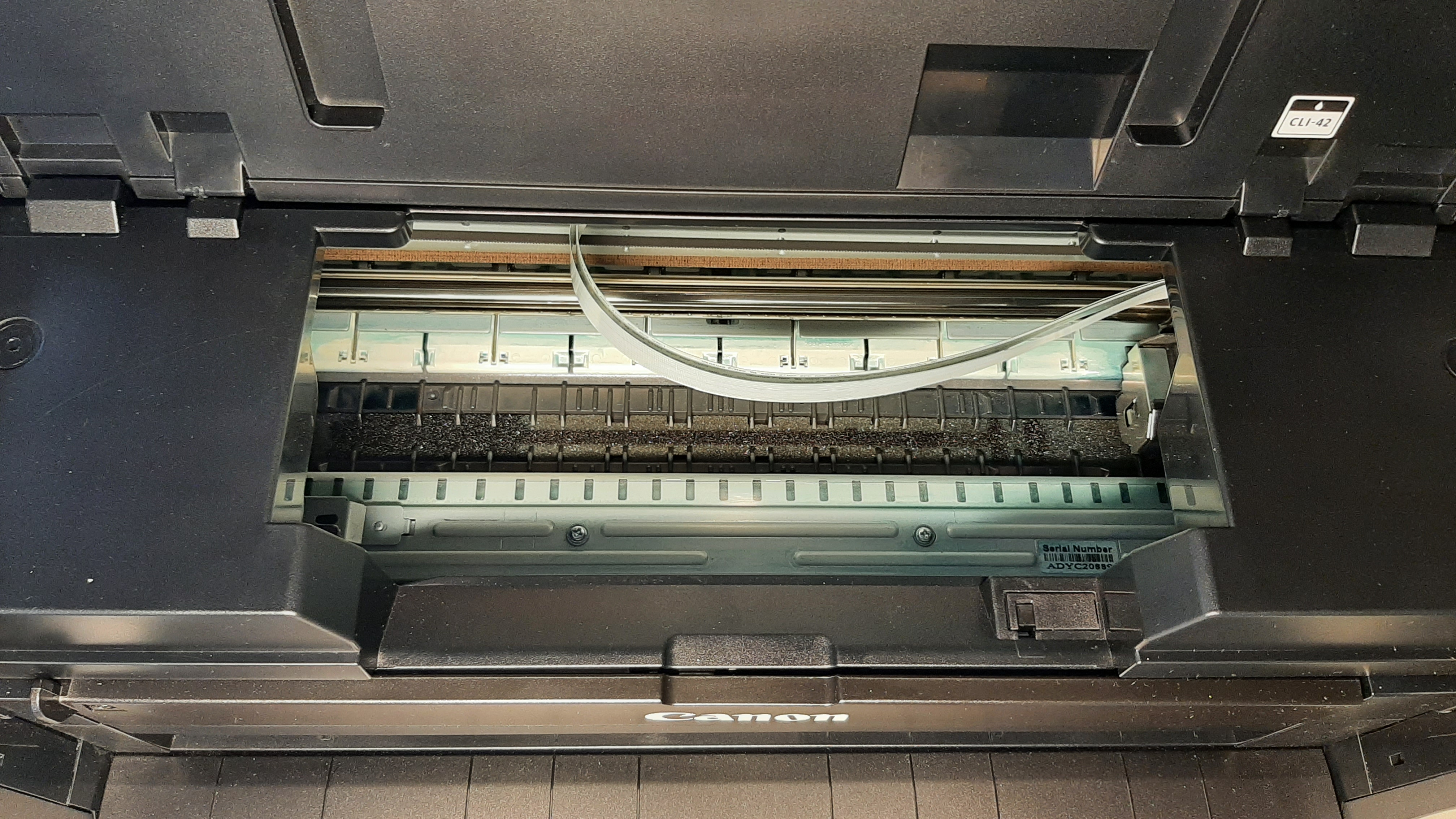

Hello,
I'm new too and I may have a similar problem with a Pixma Pro100S.
The Cyan and Photo Cyan are just absent. I runned several deep cleanings but nothing changes. I also noticed the inside of the printer is filthy with cyan ink...
Should I just clean everything and do a manual cleaning of the printhead (with ammonia) ?
Thanks very much for your suggestions

@milobluefoot wrote:Hello,
It may be perspective, but it looks like the two cyan cartridges are sitting different than the others. Are you sure they are seated correctly?
02-21-2021 08:01 AM
Thank you, I was suspecting a failed print head as there is no streaking or lines in the print. It's smooth, just very light. I am ordering a new print head.
