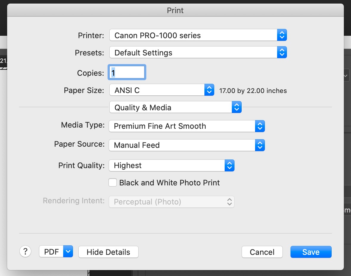

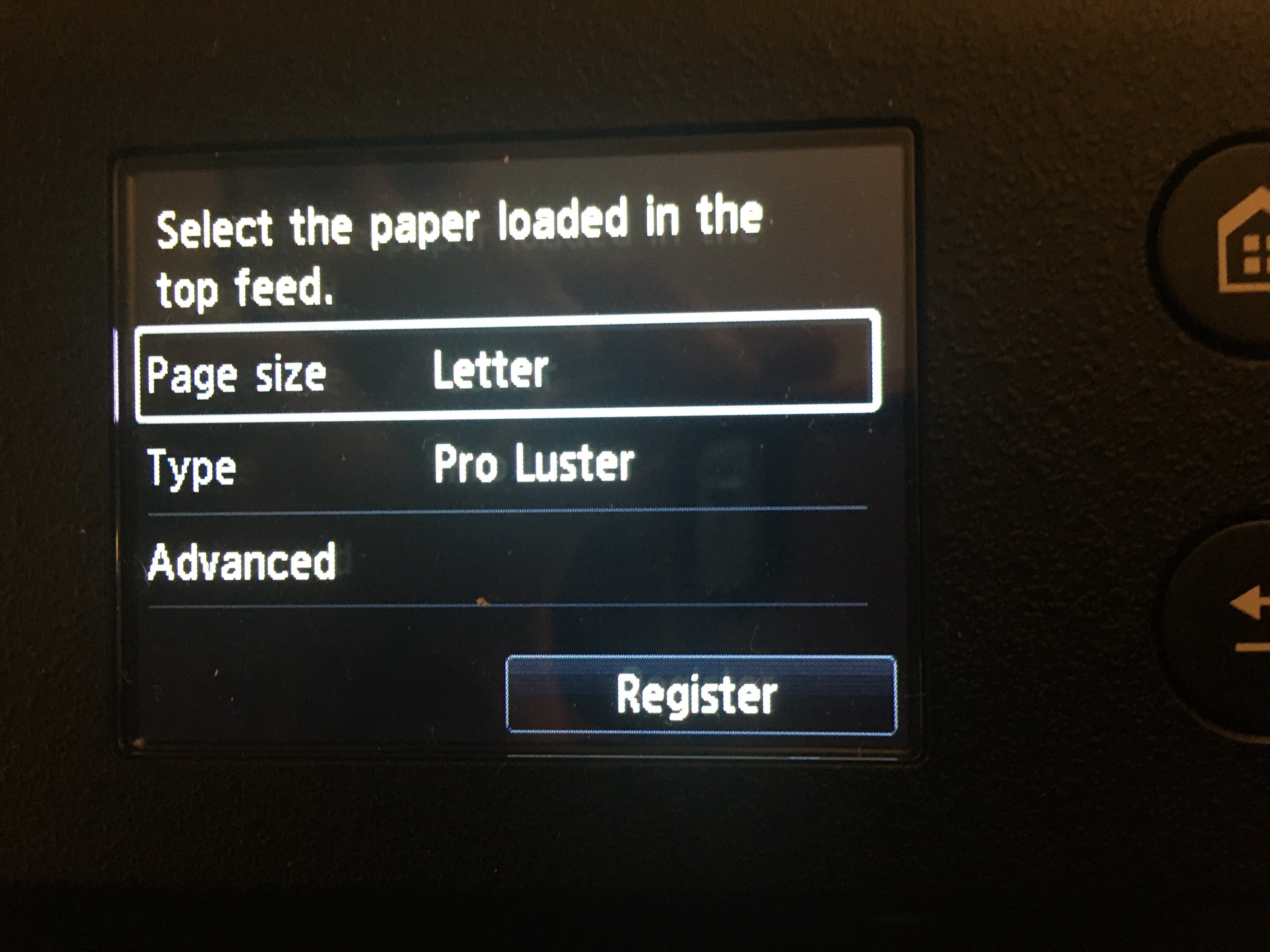

Here you can see in the screenshots that the driver seems to be fully functional and properly telling the printer what to do.  My issue is that on the physical printer when I go to set up the paper it will only let me select paper for the top feed.  I've learned that Fine Art Smooth won't go in the top feed so it is not listed and I need to use the manual feed.  Cool - I loaded Fine Art Smooth into the manual feed but the printer dialog does not change to select paper in manual feed.  It still only says to select the paper for the top feed.  Screen Shot 2020-02-05 at 10.26.56 AM.jpgScreen Shot 2020-02-05 at 10.27.10 AM.jpg

I guess I need to know once and for all: Do I need to input the type of paper entering the manual feed or will the driver override the lcd screen on the printer.  I talked to a Canon rep a few weeks ago who said the LCD screen won't show Fine Art Smooth, but other people are saying it will when the printer reads that there is paper in the manual feed.  My Pro-1000 simply won't let me select paper being put in manual feed. It will only let me select paper entering through the top feed.
The rep had me cheeck the "Cancel margin regulations" box in the paper detailed settings of the driver when printing to override the printer error. Is this the right cource of action or do I need to somehow figure out how to get my printer to recognize paper being entered in the manual feed?Screen Shot 2020-02-05 at 10.53.42 AM.jpgScreen Shot 2020-02-05 at 10.47.10 AM.jpg

This is what I CANNOT get. This is a screenshot from the manual.
All i can get is this:
So I'm good for paper loaded in the top feed, but it seems like it won't let me choose paper for manual feed.

The screen you cannot get is only activated when the paper is deep inserted in the manual feed tray.
Jx
I needed to carefully adjust the paper so it goes deep inside the printer and only when it touches the bottom it activates the other screen.
What do you mean by deep inserted? I'm pushing in as far as the paper seems to go.  Am I missing something?
On my printer the paper first stop at the entrance and then you can gently push it to make it go further inside.
