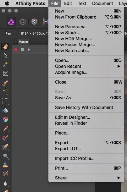

Here is what I'm running right now.  I was able to move the print area around in the dialogue box right before updating to High Sierra.  That was with Photoshop.  I have switched to Affinity Photo now though.
I don't know that these screenshots are going to be any help really but heres what I'm looking at in Affinity.

Thanks for the response.  I'm assuming I'm probably just going to have to pre-cut my paper in the end.  Not a huge deal but it wont allow me to maximize the space.
You may want to watch this video... by Affinity Photo... which explains how to get the control you want when printing.  This video is specific to Mac (there is also a Windows version).
The first part will discuss color accuracy.  The second half talks about layout, cropping, and how you choose where the print shows up on the page.
Tim Campbell
5D III, 5D IV, 60Da
I notice that the Scale is set to 30%. Is that deliberate on your part?

Thats what I'm looking for.  Brilliant!  Watch the tutorials... Who would have guessed? Smiley Very Happy Thank you so much.  It's definitely not as intuitive as photoshop.  I'm sure there's a benefit to doing it like this though.  Maybe just more control over the entire process.
Thank you so much!  This solved my problem and I am back to work! Heart
