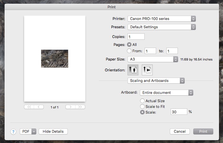

Here is what I'm running right now. I was able to move the print area around in the dialogue box right before updating to High Sierra. That was with Photoshop. I have switched to Affinity Photo now though.
I don't know that these screenshots are going to be any help really but heres what I'm looking at in Affinity.
and in the print dialogue box.
Thanks for the response. I'm assuming I'm probably just going to have to pre-cut my paper in the end. Not a huge deal but it wont allow me to maximize the space.

I notice that the Scale is set to 30%. Is that deliberate on your part?
05-10-2018 03:50 PM
Thats what I'm looking for. Brilliant! Watch the tutorials... Who would have guessed?
Thank you so much. It's definitely not as intuitive as photoshop. I'm sure there's a benefit to doing it like this though. Maybe just more control over the entire process.
