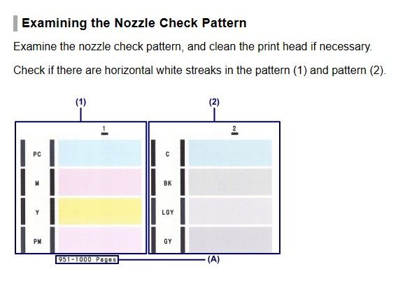

If you state that the nozzle check is printing correctly, as shown below:
then the problem is most likely related to your printing software settings.

Hi there John and thank you!
Yes, the print test looked just like that. It was streaky at first but after running several deep cleaning cycles and changing out all of the carts it’s printing fine.
