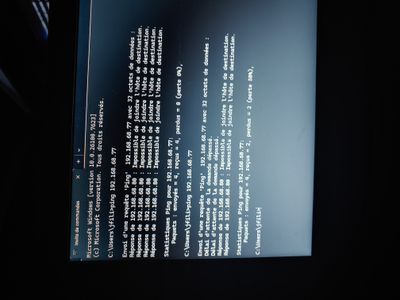

We are not going to be able to move forward until we understand why you can't ping the printer from the laptop.

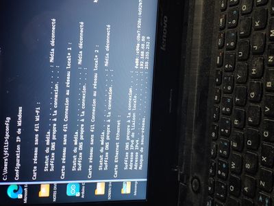

Hi, yes it's a combo, from my Internet provider. I checked the printer IP provided by DHCP and it's the same in my modem router, no problem for that. It's only on the screenshot Canon print service page provided that the IP is different my printer IP is; 192.168.. 68.77 and on the screen shot of cps it's different, I don't know if it's normal? because the cps can't reach the IP printer,  or it's stock on 192.168.68.68 , maybe it changes when it's reaching the right printer IP, I don't know that. But what I know is that I can not also reach the printer IP from my laptop and last time, 2 weeks ago I could. Something is blocking me. It must be the firewall but where??? In the firewall. Yes I'm using add blockers on Android and win 11 but I tried to ping the IP printer with both blockers off, no success. Yes CPS is for Canon print service. Maybe the add blockers changed something in my firewall?. Thanks for your help
Hi thanks here's a screenshot of the ping

Your computer's IP is? (you didn't state)
You can also use >ipconfig /all from a command prompt 😉 which would let me see the IP address, subnet mask and gateway
Your Phone's IP is? (you didn't state)
For now, don't worry about the Canon Print App.  I'll make further determination on compatibility once we get some additional information.
I'm curious.  Is your laptop running windows 11 24H2 for ARM.  Does it have a Snapdragon processor?
If unsure, click the start button > Setting cog, System > About.  Is it Intel , AMD or ARM?  The build number on your command prompt has me wondering.
I think we are closing in.  😉
Hi thanks, my computer IP and the rest in the screenshot on here, phone Android ip192.168.68.69. processor AMD a6-6310 APU with Radeon r4 graphics. No Snapdragon.. Really appreciate your help. Thanks

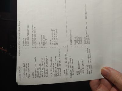

jo6
This is the printer network configuration page in screenshot

You've giving me bits and pieces, but they are helpful 🙂  Do you really need a CIDR /22 and 1022 IP's on your home network?
Address:   192.168.68.1          11000000.10101000.010001 00.00000001
Netmask: 255.255.252.0 = 22 11111111.11111111.111111 00.00000000
Wildcard: 0.0.3.255 00000000.00000000.000000 11.11111111
=> Network: 192.168.68.0/22 11000000.10101000.010001 00.00000000 (Class C)
Broadcast: 192.168.71.255 11000000.10101000.010001 11.11111111
HostMin: 192.168.68.1 11000000.10101000.010001 00.00000001
HostMax: 192.168.71.254 11000000.10101000.010001 11.11111110
Hosts/Net: 1022 (Private Internet)
 I noticed your SSID name is Primus_65674_Guest
If this is a guest network, its likely device isolation is keeping devices from communicating and seeing one another.  It doesn't matter if the devices are on the same network.  This is typical of guest networks.  Might this be the problem?
