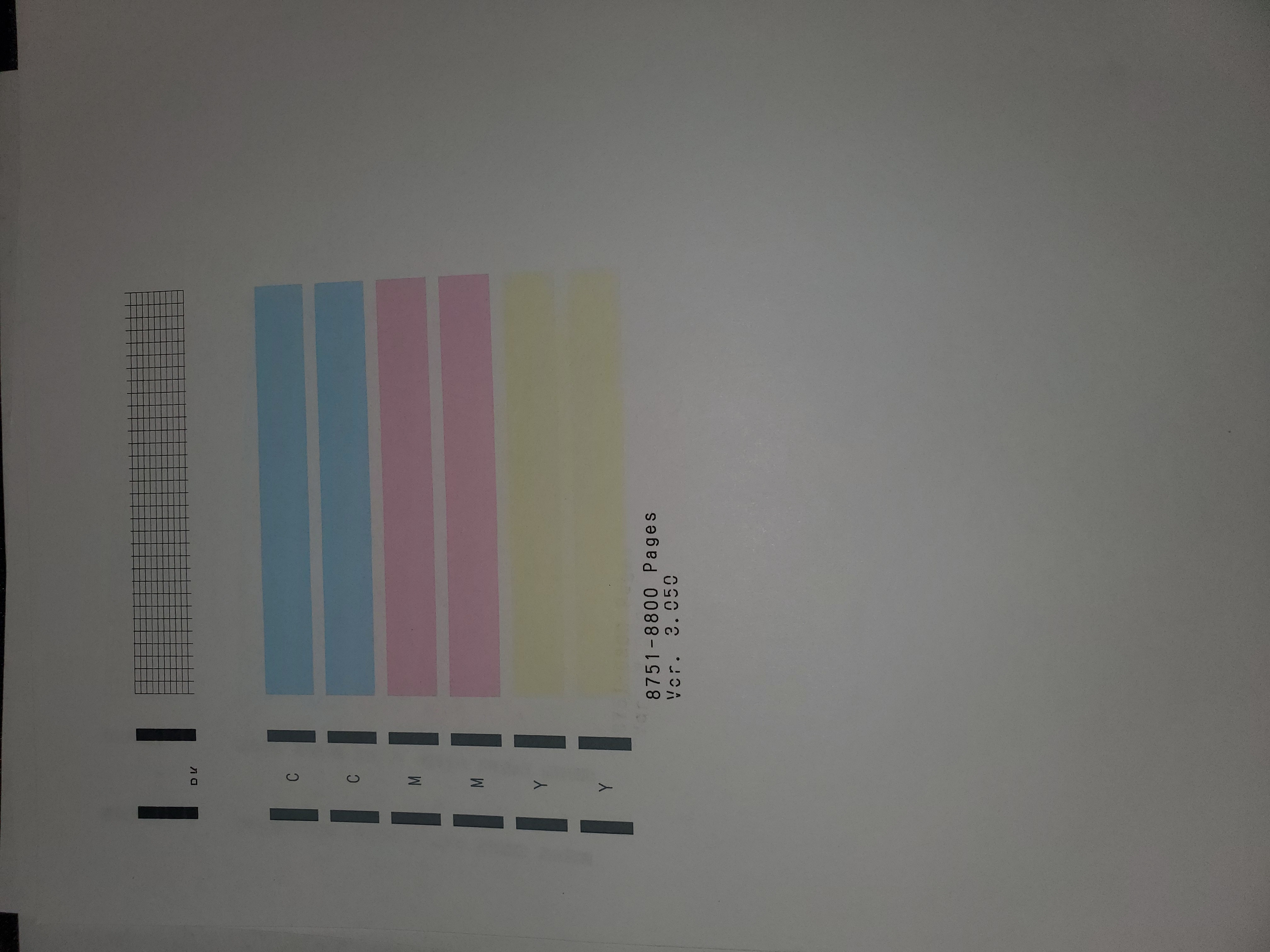

My MB2720 just started doing this exact same thing! It's only about 2.5 years old. When Printing or Copying in Standard quality, it skips two of every three lines (or so) of text. When printing in High Quality, it usually prints everything but the black is very light. And the print head check pattern looks exactly like the one in the previous post - missing the bottom half of the black pattern, but what is printed of it looks fine.

I cleaned the strip and did get some black off of it. Doesn't look like any "grease" looks more like a bit of black ink. I haven't had a paper jam in a year. Still have the same missing lines after cleaning the strip. Printing out the page after cleaning the cartridges comes out exactly the same as those who have posted a pic--the black part at the top is missing lines,yet the colors all print out fine.
