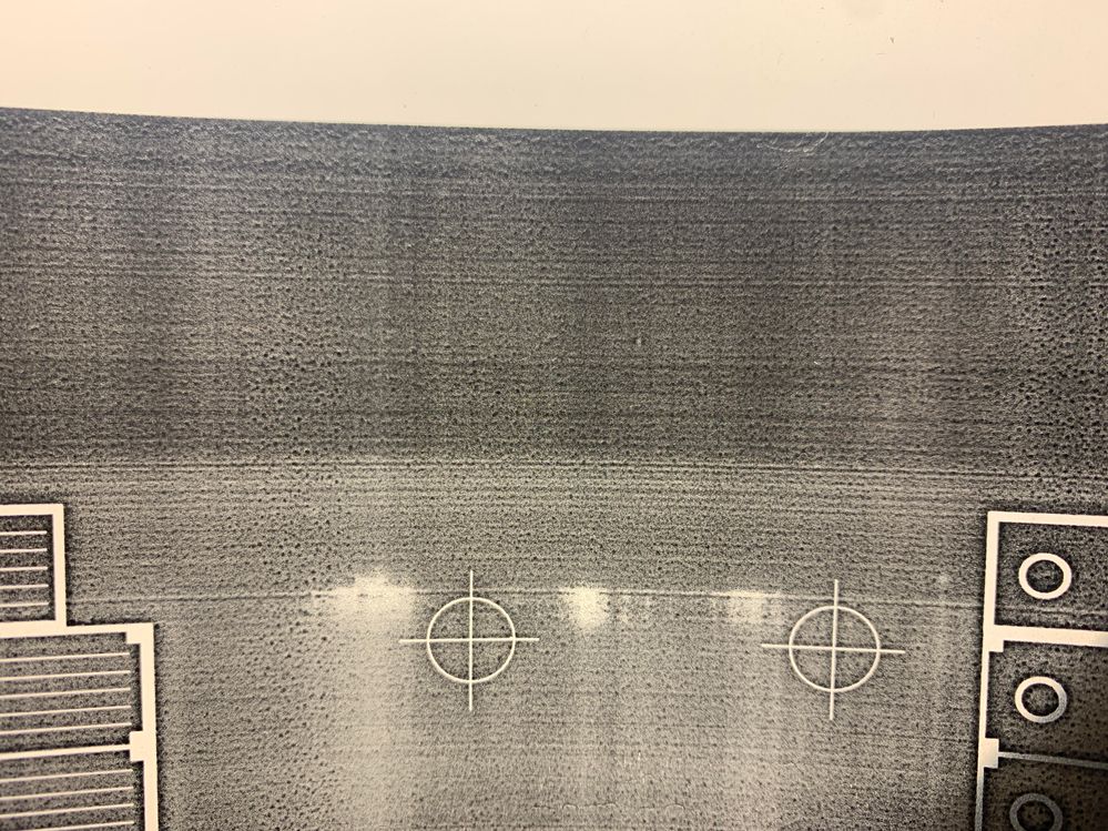

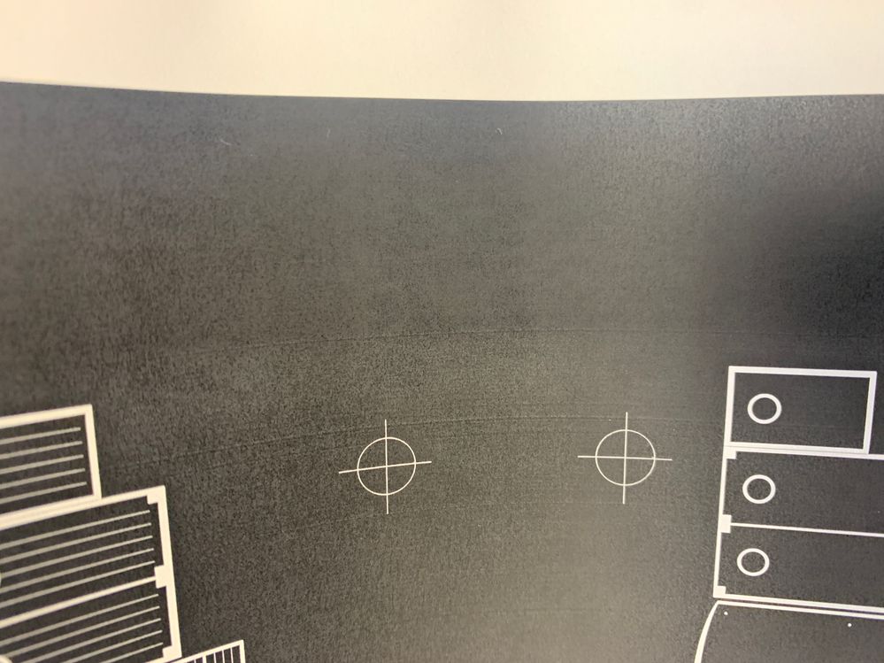

Brand new LBP6230DW. Having print quality issues. The first part of the print is dark (ish), the rest of the page is lighter and all of it is inconsistent. Using updated driver and have played around with print quality settings (toner density) with no effect. Toner Save is off. Paper type has no effect. Its most noticeable on transparency printing which is what I purchased the printer for. On plain paper it is still noticeable.
Is this a product defect? Toner cartridge issue? Config issue (i.e. print preferences)?

Hello,
