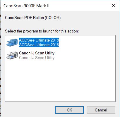

No, none of the buttons work, except that it triggers the foloowing as in screenshot. Pressing OK for any of the options doesn't do a thing

From that screenshot, it looks like there are at least two imaging programs installed on the computer. When the Auto button on the scanner is pressed, the computer recognizes that a button has been pressed but needs further direction what to do with it. This doesn't happen when scanning from the computer, because the appropriate program is already open. Re-installing the drivers may associate the button-press with the correct program.

The other photo software I have is ACDSEE ultimate 2018 (you see that in the screenshot I attached).
