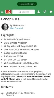

What lens are you using?
I suspect the cup/mug that you appear to be trying to focus on is too close to the lens:.  Every lens has a different MFD specification, minimum focus distance.
That looks like the kit lens. If it is there are no switches on it to control, AF/MF, IS & the control ring. Instead it’s controlled from the camera menu for RF & RF-S lenses that lack these switches. Some RF & RF-S have physical switches that control those functions. When they lack those switches those settings are controlled from the camera menu.

Maybe.  It’s an STM lens.  The STM lenses are “focus by wire.”  I am not familiar with the RF version of 18-45mm lens.
The R100 is basically the M6 m2 with an RF lens mount. The lens seems to be an RF adaptation of the EF-M 18-45mm lit lens. I do not know whether this lens has “zoom by wire.”  The camera does have a setting that you can enable to “retract the lens on power off.”  The existence of the setting suggests that it could have electronic zoom.
@Waddizzle all RF/ RF-S lenses are focus by wire. Doesn’t matter if it’s VCM, USM or STM. The only non-focus by wire RF lens is the RF 75-300mm F/4-5.6 lens. The only reason this lens isn’t is because it uses Micro Motor. Then also it’s an old EF lens that was repackaged for the RF Mount.
-Demetrius
Bodies: EOS 40D & EOS 5D Mark IV
Lenses: EF Holy Trinity, EF 50mm F/1.8 STM, EF 70-210mm F/4 & EF 85mm F/1.8 USM
Looking at the lens online is a curious one. The lens has a physical zoom ring, but it has a retractable setting (white dot) and you rotate it to the left to get to the focal length options. I understand the concept of zoom by wire, but if the ring itself will not move...That's what's confusing me.
