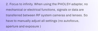

The PHOLSY EF=>RF adapter has no contacts, in fact PHOLSY describes it as a "manual focus" adapter with "aperture control", which is a partially knurled ring on the adapter, although I don't see how it can control the aperture without contacts(??). In short, the answers given by Steve and infinityone are correct, to an extent.
I would return the PHOLSY adapter and purchase the low end version of the Canon adapter, or at the very least one that has contacts. If you want to shoot manual focus only, you will need to go into the Orange Menu, Number 4, Select "Release shutter w/o lens", and turn it "on". Just keep in mind that it will still be a "manual" lens, so you will have to set aperture and focus manually, but you will be able to shoot.

I just reread the PHOLSY descrition. So no aperture opperation for the lens, even if you do enable focusing.
