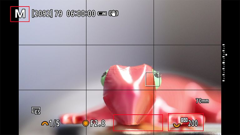

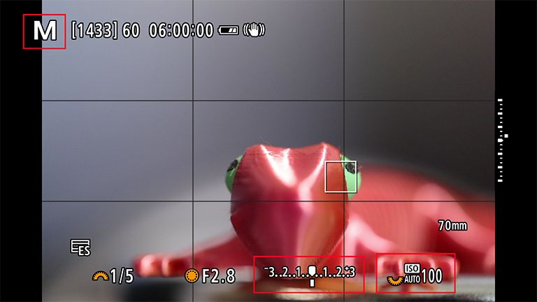

Hello. I'm having a problem with my R5 II that I hope you all can help me with. I normally shoot on manual with Auto ISO. When I do that, my light meter can be seen on the bottom of the screen. See Pic1. But when I change from Auto ISO to a fixed ISO, the light meter disappears from the bottom of the screen. See Pic2. I’ve changed the VF vertical display (found under Shooting display info under the 9th (last) tab of the Shooting (red) menu) to Yes and No and back again. Repeatedly. It doesn’t help. The only thing that I’ve found that makes the light meter reappear at the bottom of the screen is to switch the ISO back to Auto. But that's not always the setting I want to use. Can anyone tell me how to make the light meter stay on the bottom of the screen regardless of my ISO setting? Thank you in advance. Mary
The light meter is visible at the bottom of the screen when shooting on Auto ISOThe light meter is visible at the bottom of the screen when shooting on Auto ISOThe light meter is no longer visible at the bottom of the screen when shooting on fixed ISOThe light meter is no longer visible at the bottom of the screen when shooting on fixed ISO

I know all about exposure compensation and I use it frequently. I am actually a very experienced photographer. I've been using an r6 and an r6 II for years and DSLRs and film cameras before that. I just decided to upgrade to the R5 II. And my r6's show the gauge regardless of my ISO setting.
Whatever you call. it, that gauge is an indication of exposure. It is a light meter. It shows the exposure of the scene in the viewfinder. And without it, how am I supposed to determine how the lighting of the scene can be judged against what a light meter would consider neutral exposure? Yes, I can use the smaller light meter that shows vertically on on the screen, but that is so much smaller that it's just not that useful. And, yes, I could use the histogram but that is much more subjective.
So are you saying that the R5 II won't show that gauge on the horizontal unless I want to forever shoot on Auto ISO?
You need to have at one of your 3 exposure methods on auto for the compensation to work and your screen shot on the second photo shows full manual.

I believe the reason it disappears when using manual ISO is because the camera doesn’t have any automated settings to calculate an exposure compensation value. When I shoot with this method I depend on ExpSim through the viewfinder.

You have fixed Shutter speed, aperture and ISO. What can the camera adjust to get you the requested exposure compensation? I believe the exposure meter is on the right.

If you look on the right side of the your photos  you will find the exposure scale to be used when all settings are set as manual. This position can be modified.

Are you sure your R6 showed the exposure scale on the right side of the viewfinder. I only have the bottom scale with my R6 Mark III.
John Hoffman
Conway, NH
John
I have the R6Mii and the exposure display is on the bottom. With the R5Mii it is by default on the right of the screen with a vertical orientation. I think that OP is used to seeing it in the bottom and  it does look strange in the vertical mode.
