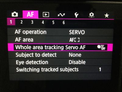

 Enable Whole Area Tracking, thought.

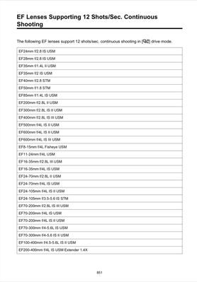

@bill1952 I would take a look at what @Waddizzle posted. He owns the same camera as you. I would also suggest discontinuing using H+ shooting mode with that lens. It’s just too slow for that kind of frame rate. Just use Continuous High shooting drive mode. Not H+ drive mode because the lens will cause the camera to slow down.
-Demetrius

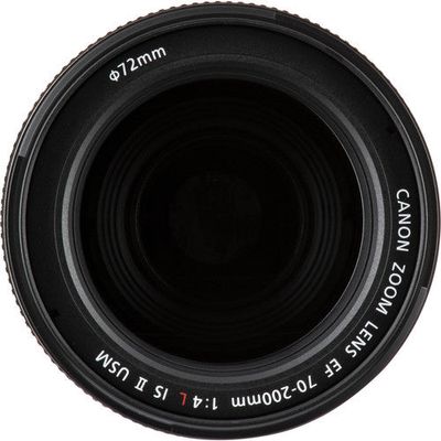

Hi @bill1952 which EF 70-200mm lens do you own. We need the exact name. I have pictures below to help you identify your lens model. Canon has made multiple versions in the EF Mount. Older versions are NOT fully compatible with EOS R series cameras. This is due to the older hardware in them. Older lenses cannot achieve 12 fps or support more modern features like eye detect AF.
-Demetrius
Bodies: EOS 5D Mark IV
Lenses: EF F/2.8 Holy Trinity

In order to reproduce the problem that you’re having we need the exact lens model name. We could easily use the wrong lens not knowing why a problem is NOT reproducible. The 1st gen 70-200mm F/2.8 IS lens is NOT fast enough to keep up with 12 fps. It may not even be able to keep up with eye detect AF. Just because you can set such settings in the camera menu. Doesn’t mean the lens supports it. If the lens doesn’t support it. The camera will automatically throttle back the speed to match what the lens is capable of. Also what mount adapter are you using too. The Canon brand mount adapter or a 3rd Party mount adapter. I would also check the setting called “Preview AFContinuous AF”. Set this to DISABLE it’s not only a drain on the battery. But older EF lenses that provide focus override in AF. AF cannot be overridden if the camera is driving the AF motor. That particular setting causes the camera to constantly drive the AF motor. So focus override in AF mode is NOT POSSIBLE. You’ll feel internal pushback from the lens. If you attempt turning the focus ring when the camera is driving the AF motor. This is the lens’ clutch doing its job to prevent damage to the lens. All RF are focus by wire and don’t have this limitation like older EF lenses do. Can we have some example pictures too with metadata attached to them too. Preferably RAW (JPEG is fine too) files on Google Drive or any other file sharing service.
-Demetrius
