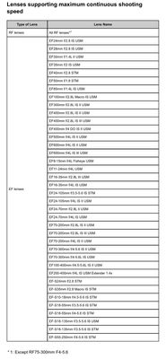

@bill1952 The lens model that you provided to us is NOT capable of 12 fps. Unless you gave us the incorrect model name. The lens hardware is too slow for 12 FPS. The AF motor is more than likely NOT fast enough to keep up with Eye Detect AF. Canon has a list of EF lenses that are compatible with 12 FPS. Your lens is NOT on the list which is telling you that it’s NOT able to keep up. Thus the camera slowing down to match the lens. All EOS R series cameras have a list of lenses that are capable of 12 FPS. Lenses supporting maximum continuous shooting speed

@bill1952 I would take a look at what @Waddizzle posted. He owns the same camera as you. I would also suggest discontinuing using H+ shooting mode with that lens. It’s just too slow for that kind of frame rate. Just use Continuous High shooting drive mode. Not H+ drive mode because the lens will cause the camera to slow down.
