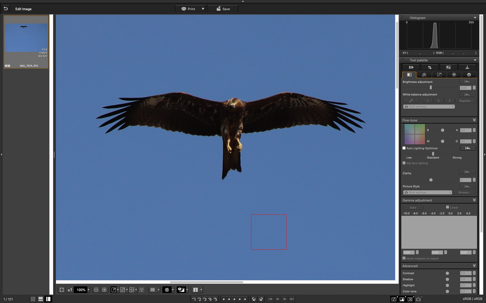

Hi. My R8 + 400mm lens combo is not giving sharp pictures when shooting birds and I realized that the AF point is rarely on the subject. Yesterday, confirmed my suspicion. When I shot bursts, I noticed that only the first picture in the sequence shows the AF box on the subject. The box is not on the subject for the other frames in the sequence. In the EVF, however, the tracking box appears to be on the bird 90-95% percent of the time. I've set a shutter speed of 1/2500 s and an aperture of 7.1 to minimize camera shake. Despite this my pictures are soft and have this AF box problem. One thing to note is that I'm shooting in EFCS shutter mode and the burst is set to continuous (no H+ or H). That should not be a problem though. I'm attaching a screenshot showing the problem (this wasn't shot yesterday).
I am struggling to understand why this is happening. I've seen reviews where people have praised the exceptional tracking of the R8 but I am not seeing it (at least via the images). Why would the tracking be accurate on the EVF but not on the images that were shot? If it's a lens issue, then shouldn't the problems also appear on the EVF? Could there be an error with the AF? It may be that the focusing system in the camera is tracking but the lens is unable to keep up?

Where is the AF point located releative to the subject? Zooming in on the bird has hidden the AF point(s). Can you post a RAW file of the sample image to a public file sharing platform like Dropbox, etc.
Exactly which 400mm lens are you using? Judging from your screenshot, it seems you are using the EF 400mm f/5.6L USM. If so, then the lens is the most likely cause of your issue. It does not focus fast enough for the highest frame rates the camera is capable of using.

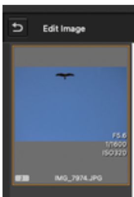

It is possible that the AF cannot use the whole area of the frame, and your subject is rather small and near the edge of the frame. (Judging from the thumbnail on the top left, and the 100% zoom below the image. I don't know what the specific AF area is for that lens 7 EOS R8, but it might be a factor to consider.

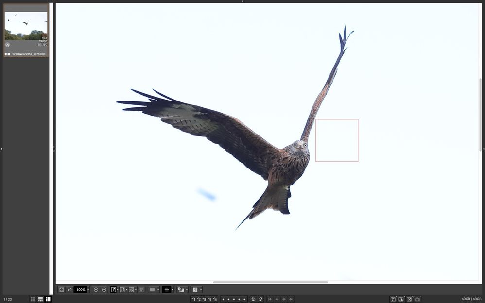

I have some examples myself where the AF point recorded does not match the subject. I was using the similar EOS R6 Mark II (shares the AF system with EOS R8) and a newer EF 70-200mm f/2.8L IS II USM lens. I was photographing red kites in flight, and these birds are similar sized to what you showed. First one is with the image filling the screen, the second is 100% zoom. Bird is sharp too.

In the example you shared, the AF box is at least near the subject. That is not so in my case. Also, the image appears a lot sharper than mine. When I shoot a burst, the AF confirmation box appears on/near the subject for the first image. The rest of the images in the sequence are, for the most part, blurry and the confirmation box does not appear anywhere close to the subject. In the EVF, however, the camera shows that it is able to track as there is a blue square on the subject.
Do you also notice a discrepancy between the tracking shown in EVF and the AF confirmation box from the images?

Brian raises a good point about AF area. The preview image doesn’t show AF points. But your main display area can. Your subject is too far away for a clear shot.

@Brian and @Waddizzle: I now understand what you mean. The subject is close to the top of the frame (in the thumbnail). Is it possible that in this case, the EVF also shows that the tracking has failed?

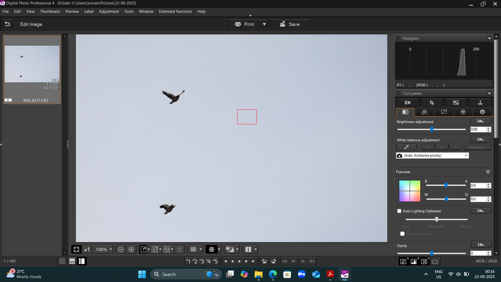

Hi. I have uploaded some raws on my google drive. You would see that the AF confirmation box is rarely on the subject. Is this a problem? Do you think that the subjects are in focus?
